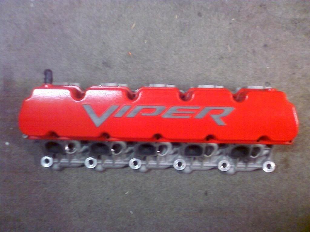

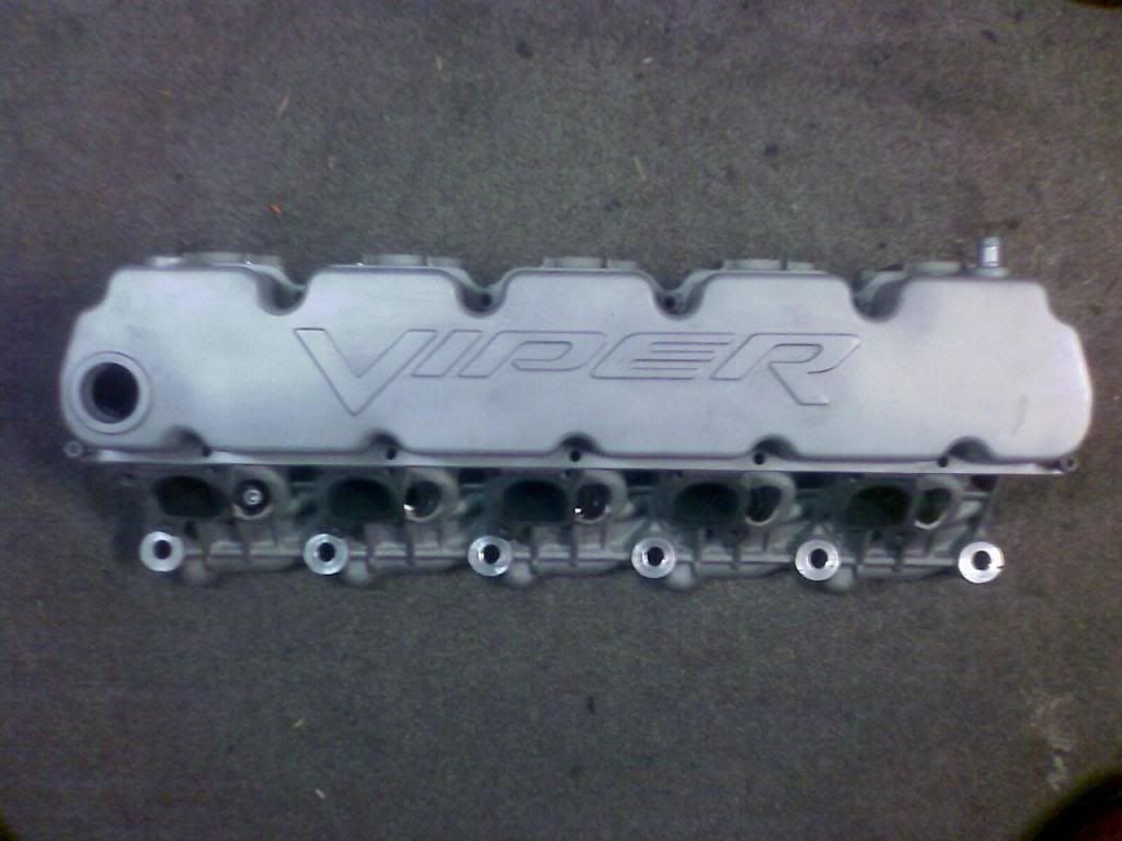

I started to prep some of the engine components.....
Stock Viper Valve Cover.....
I stripped the red paint off the Valve Covers, then smoothed them with a 3-M cookie, then some sanding block work, and finally glass beaded surface for primer adheasion......
I also started to smooth off the casting lines and casting flash on the intake manifold....
I will port and polish the cylinder heads and also port match the intake manifold ports....
