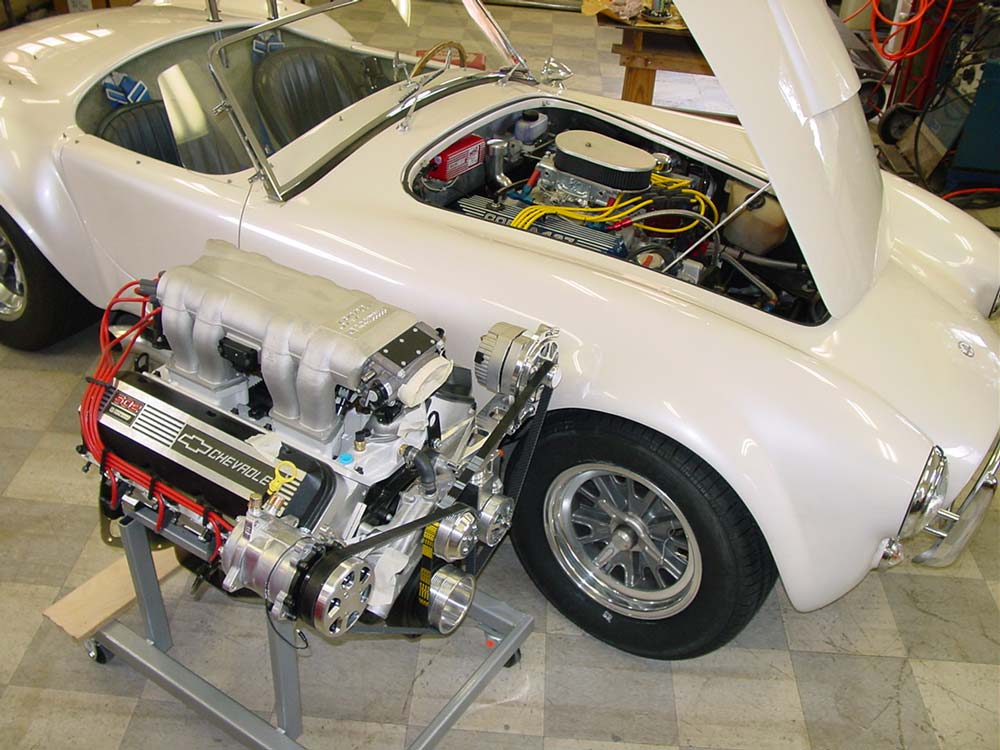

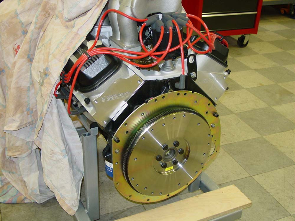

Default 502 Ramjet and T-56 Viper Transmission

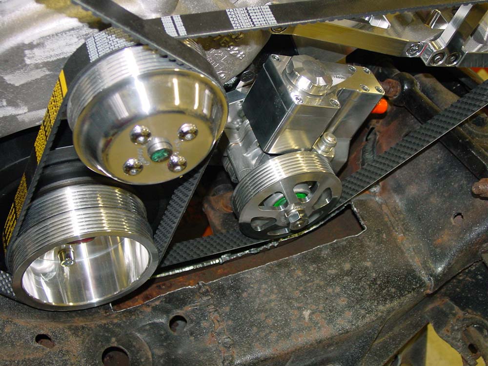

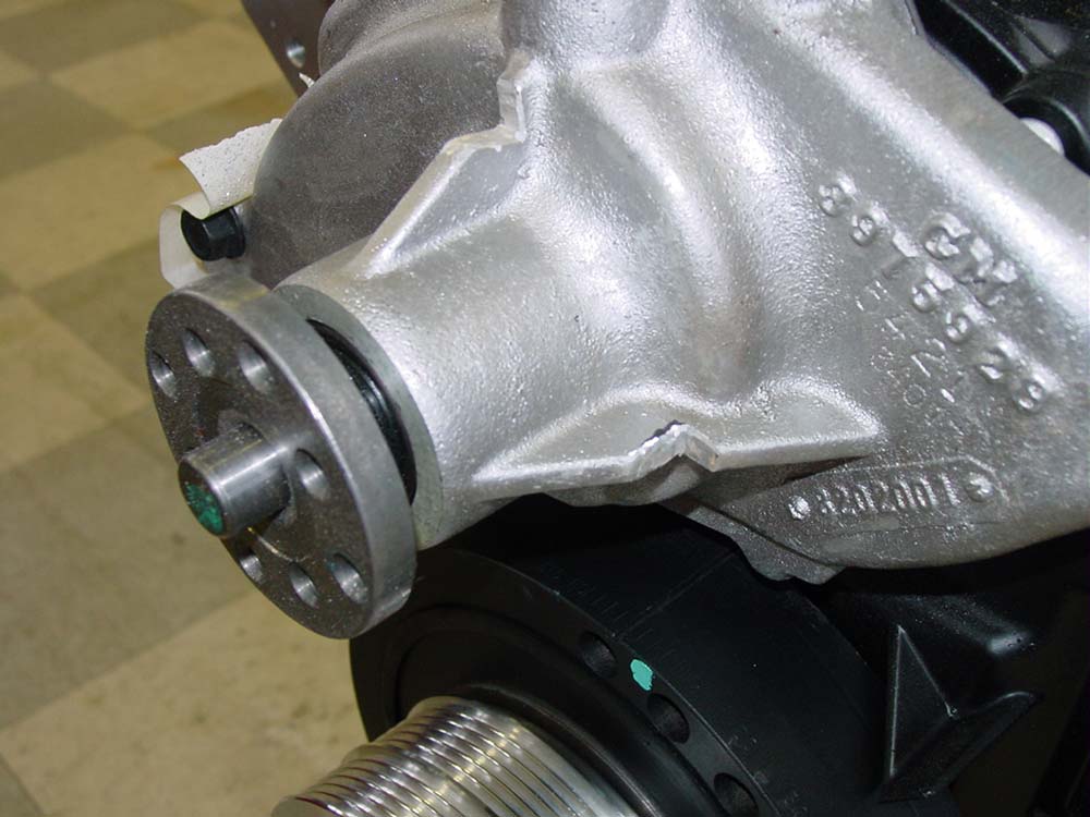

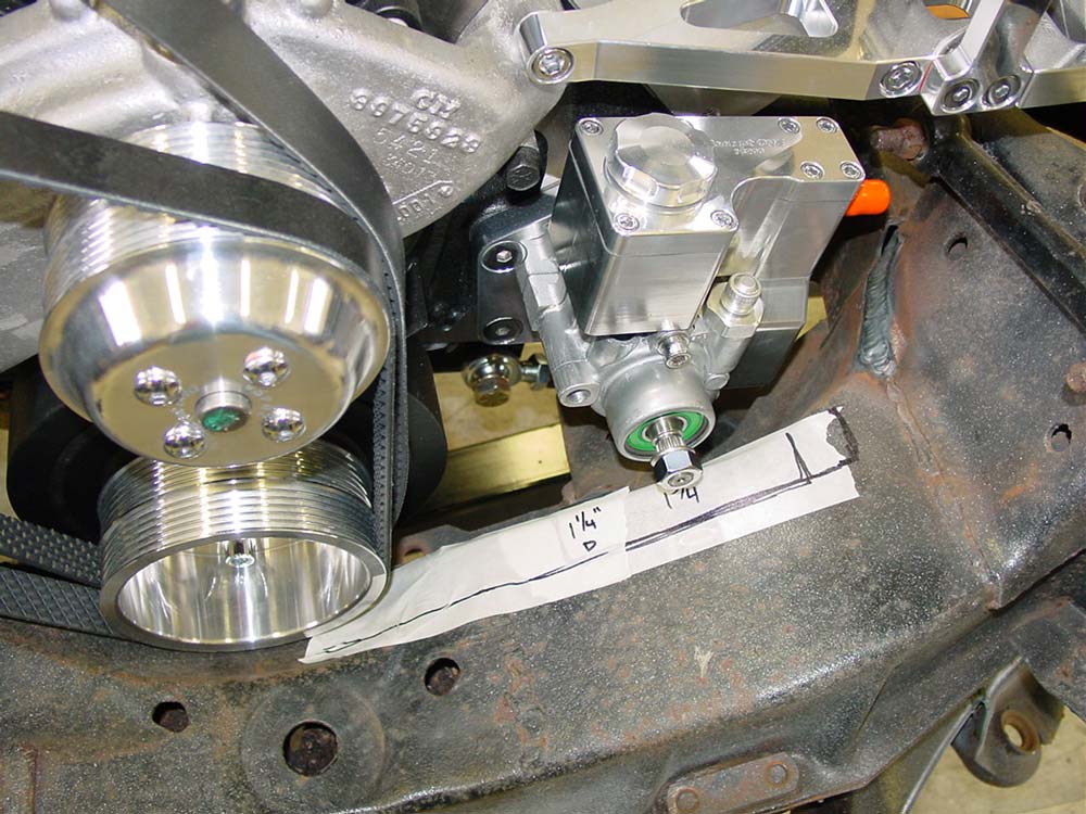

Well, a nice clean new engine can brighten up anybody's day. Here I am mounting the accessories with a Concept One Serpentine kit. Sme modification was necessary to the water pump to clear the pully.

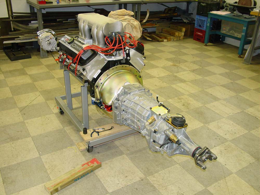

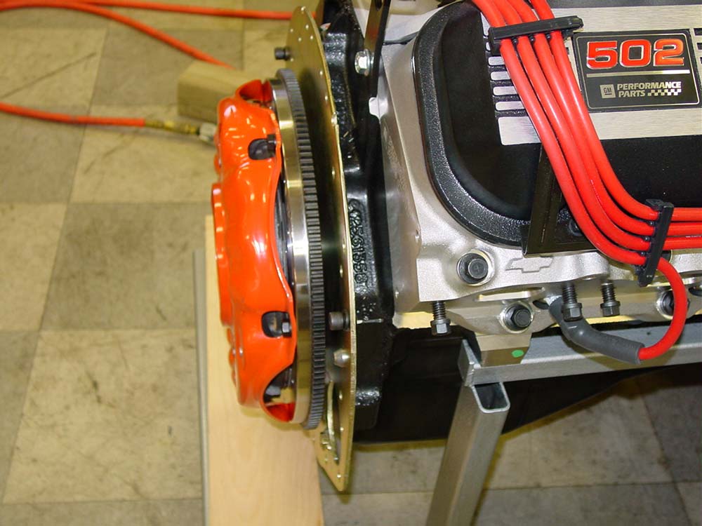

I also took off the flex plate and put on the flywheel and the Centerforce Clutch assy.
The Transmission is from Dodge and has the 2.92 first gear and the 50% overdrive. I am running a 3.70 rear gear and 25" tall tires.

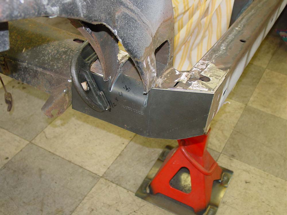

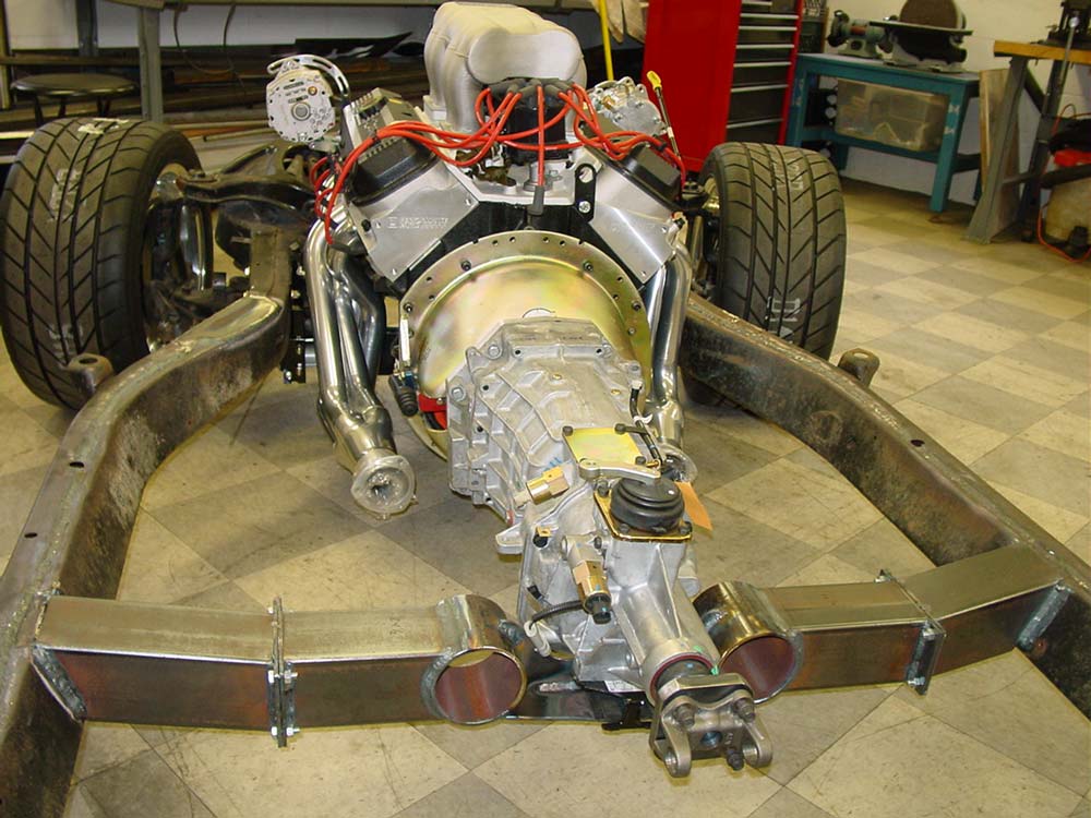

Default Transmission Mount and other Chassis Mods.

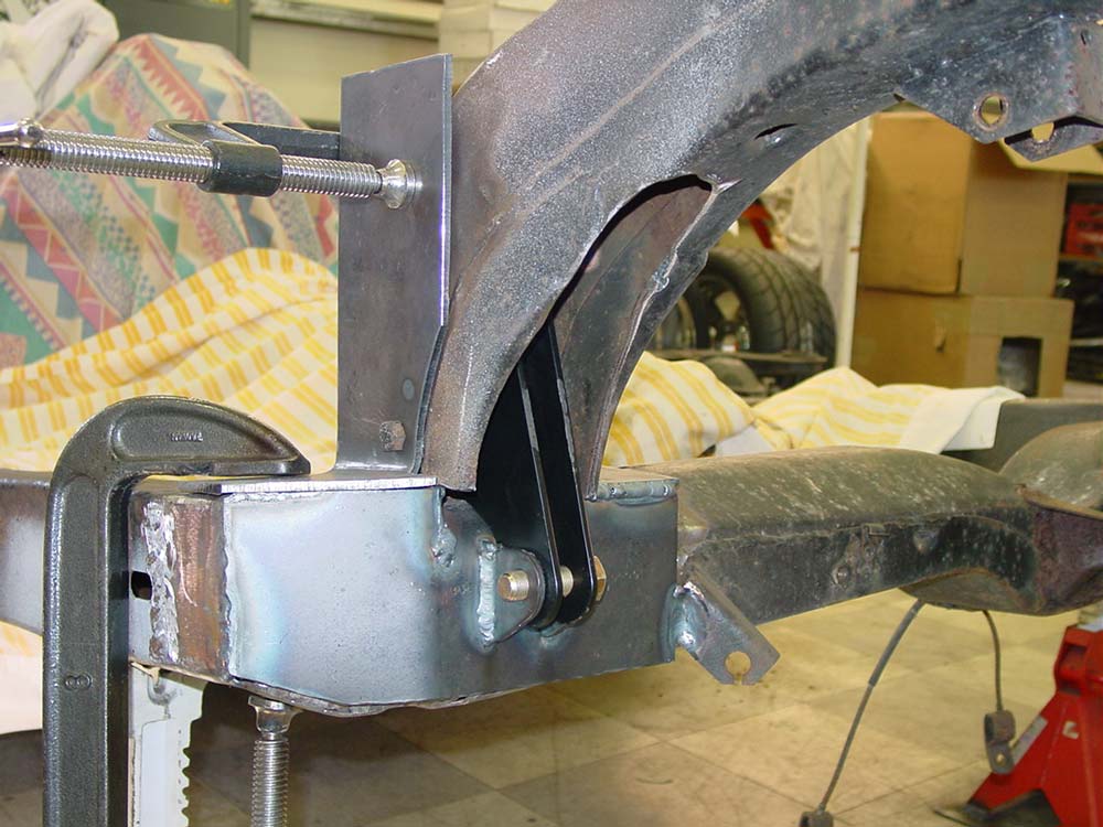

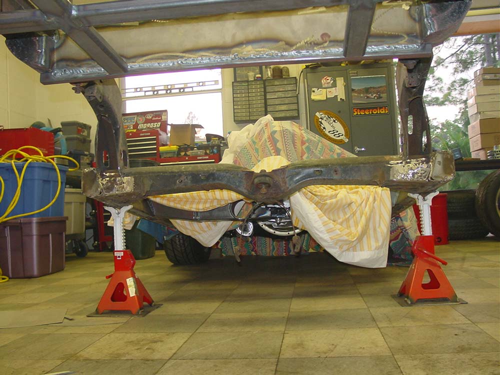

The engine/transmission assy. are about 1.5" longer than stock. This required that the transmission support be modified. At this point, it just became easier just to build a new one. I made 4" ID exhaust pass through tubes so the 3" exhaust could be accomodated, and made the center section removable.
I also added some clearance for one of the header tubes that came too close to the frame, and made clearance for the PS pump.
On the bottom of the crossmember, I made a "Bash Box", which should protect the oil pan from any "Smokey and the Bandit, or Dukes of Hazzard" moments.
All seams were welded on the entire chassis for strength.

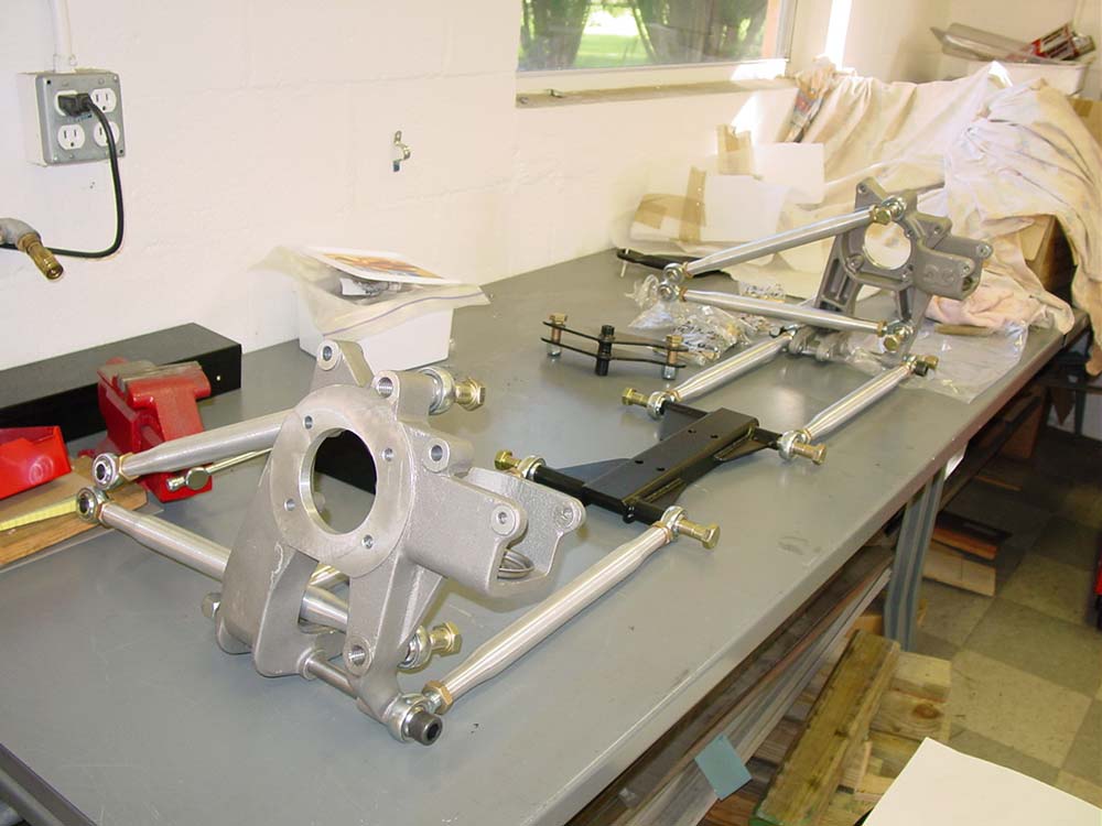

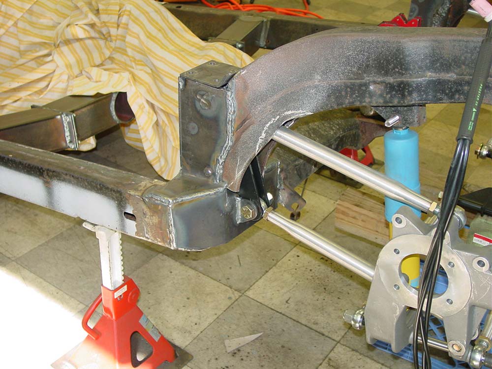

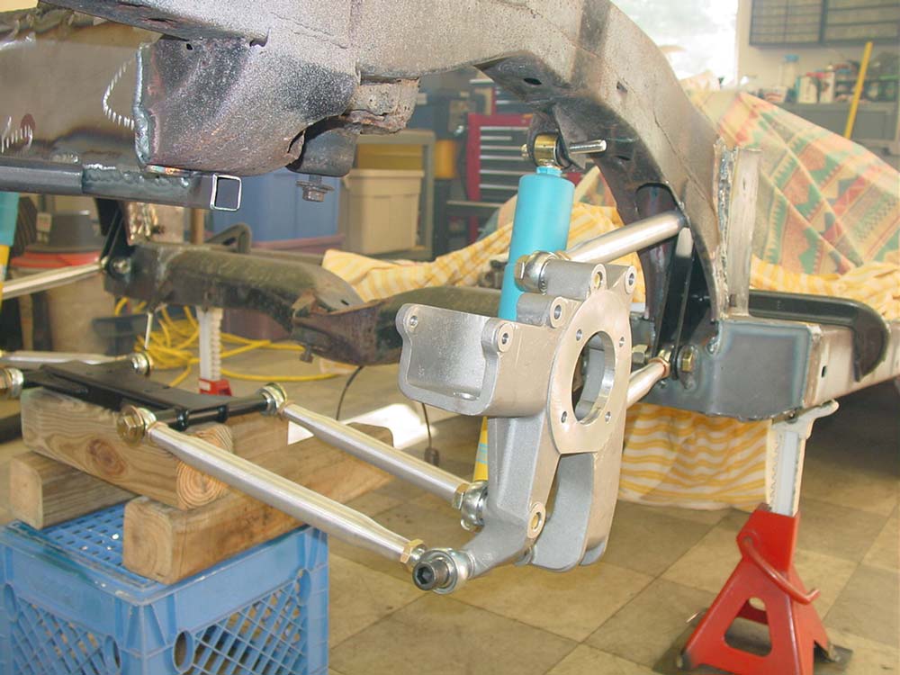

Default Guldstrand 5 link rear suspension

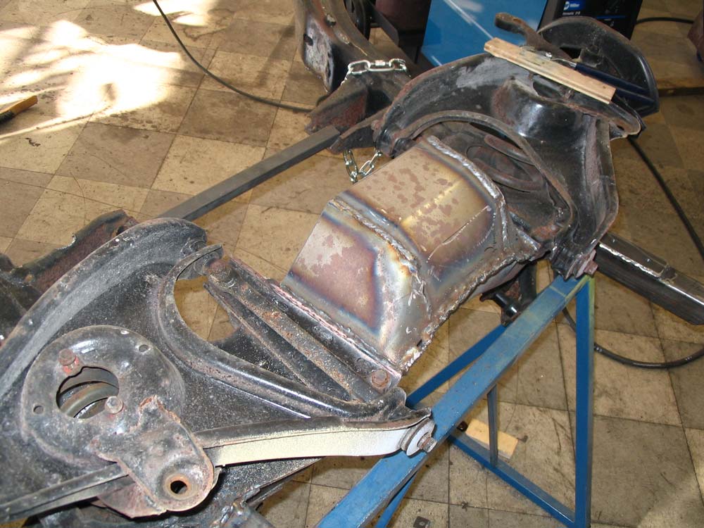

The next step on the chassis was to install the 5 link rear suspension. A lot of welding was required. I incorporated the main rollbar hoop and the forward links to the 4 length wise suspension links. I figured that there would be a lot of load on those links when I put them between my left foot and the pavement.
The roll cage is next...

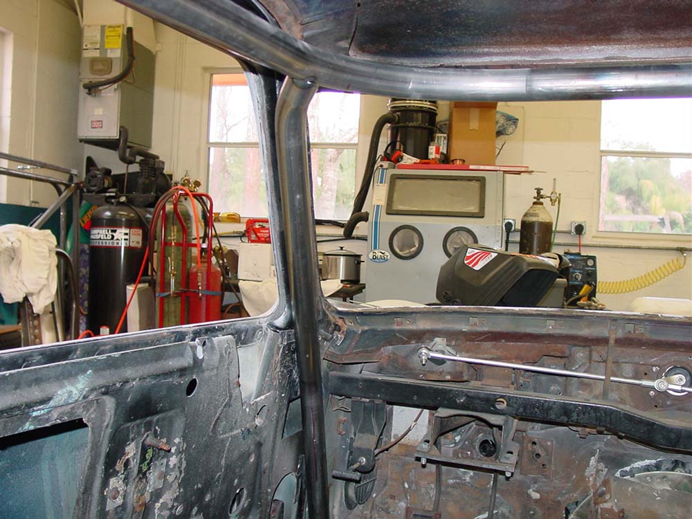

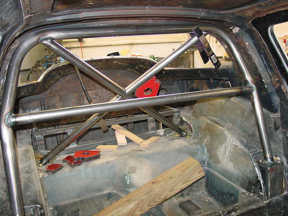

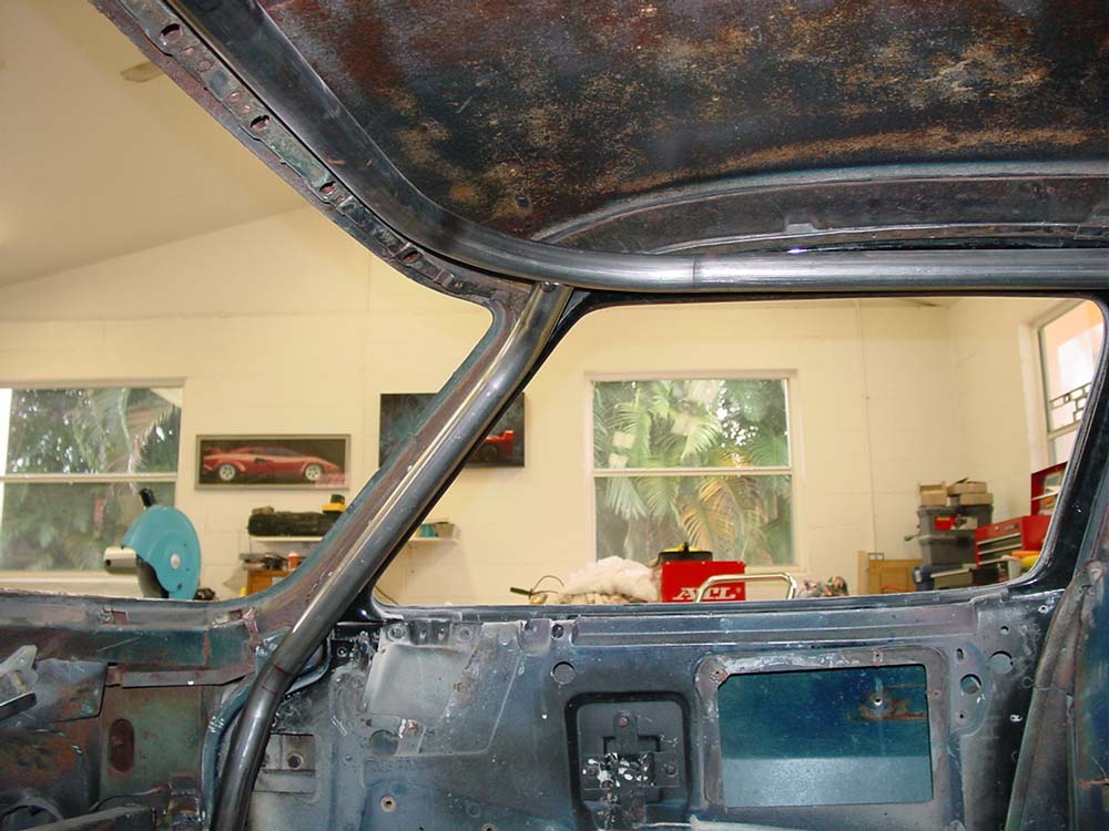

Default Roll Cage...

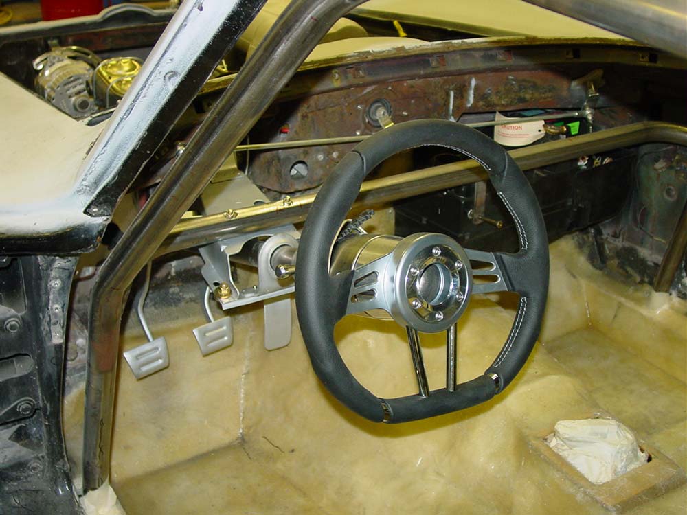

I decided that if I was going to stiffen up my chassis to deal with the extra power and tire forces, a cage might be a good idea. After doing some research, I found out the John Greenwood of Corvette racing fame didn't run forward of the dash area with any of his cages, I decided to do the same, so 10 point became 8 point. The corvette body construction causes a problem for any cages. Either you weld one in through holes in the floor to the chassis, or you have to make a cage that sits in the body, but bolts to the chassis. That is the method that I chose. It is a little bit like building a ship in a bottle.
The pictures explain most of what I did. I have added door bars which go from the main tube but end at the transmission crossmember.
Adding a roll cage points out exactly how small a car the Corvette Coupe really is.
As you can see from the pics., I was able to put the windshield bars in such a way, that there is no blocking of your view out from the drivers seat. I had to bend the drivers side bar 5 times to get it right!!!

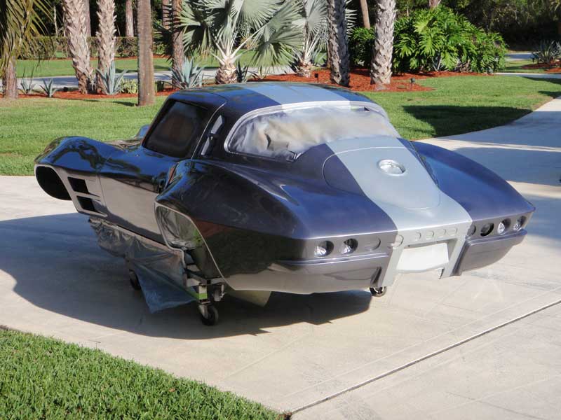

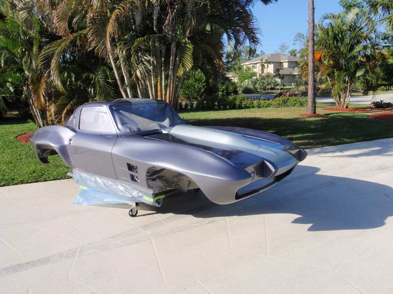

Default Finally Painted
If I ever see another piece of 320 grit sandpaper I am going to scream...
After taking out a second on the house to pay for the indispensible green masking tape, I finally put the color and clear on and pulled the car into day light.
So What do you think about the color choice?
It is a GT40 color, Tungsten and Satin Silver on the stripe.

  #20
Old 03-22-2009, 08:25 PM
silver63c10's Avatar
silver63c10 silver63c10 is offline
Join Date: May 2007
Location: Carrollton, TX
Posts: 221
Thanked 11 Times in 3 Posts
Awesome build, there is nothing cooler than a midyear Vette with a ton of rubber under it. Can't wait to see it all together, amazing work so far.
