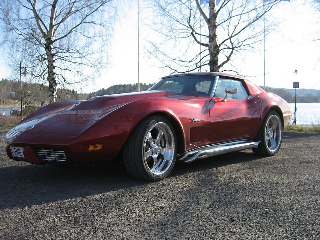

I bought the car from the west side of Chigaco in 2002 (march). I was an exchangestudent at the time in States and I had always dreamed of a American muscle. Apparently this Corvette was first right type of car for my application and I bought -> I made a good deal, because the former ovner had just purhaced a C5 vette and he had a big loan for it to be paid.

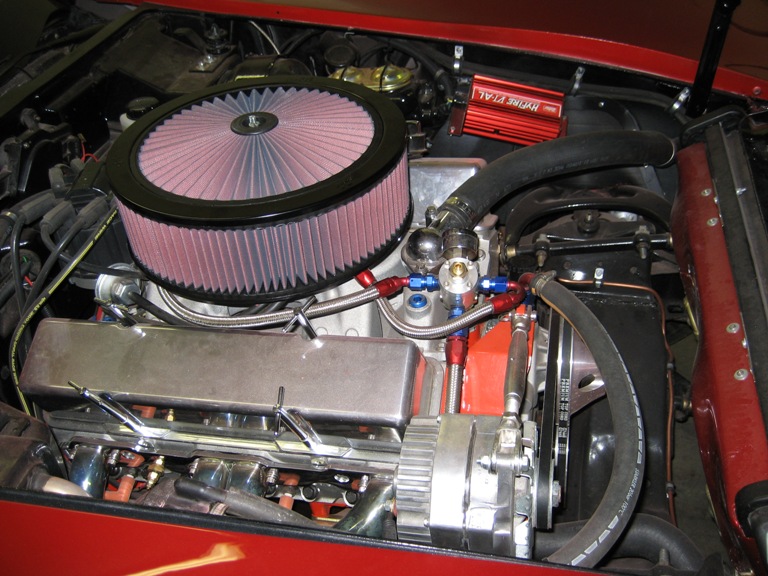

Now I have been working on this project for 7 years. I have done: full body-off restorattion -> frame and suspension components got a hot zinc couting, which is a great way to protect and stiffen the frame, all bearings are new, also all bushings are polyurethan, I made new brakelines from alu-copper-tubing, restoret brakes and handbrake, changed the TH-350 to tko-600 and build a hydraulic cluts for this set up. The engine is built in to a new block with new parts-> dart alu heads, mighty demon carb, voodoo stick, compression ration is 11.2:1 and so on... rev limit is now 6500 rpm and this set up is producing decent power to wheels.
Cooling problems I solved with two spal fans. I fabricated a wind tunnel from fiberclass for those fans to optimize the cooling power. The are really working well. Body is basically stock, but I needes some room for the new engine set up, so I fabricated L-88 scoop to the hood. The colour is from C5īs colour map and it is magnetic red.
Interior is full Italian leather, with 4 point harness and autometer meters (carbon fiber). I covered everything with leather exept the floors. I used black and light tan colours. I also made the whole wireing from the scrats and used some 800 yards of wire.
On suspension side I have QA1 semi-coilovers infront and fiberglass leafspring in back with koni classics. I have also installet some special made camber bars to back. The steering is rac and pinion conversion and it rocks! The newest upgrade is those wheel from Intro (Pentia 19X8.5 and 20X9 with Kumho KU31 245/35/19 and 255/35/20)
I have only 1600 miles on the odometer after the build up... and its still in some progress, but I love the car.
I think thats all in a nut shell...

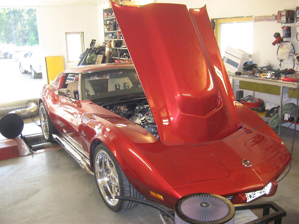

I have to update this thread... some progress over here in Scandinavia. I now have new rims, all the emblems are attached, interios is ready and I also tuned my car in a dyno... a short vid can be found from youtube "Corvette C3 dyno, Finland"
