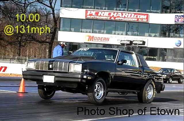

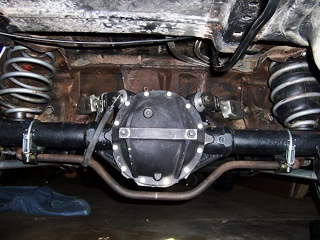

I used a stock Fbody rear bar on my Cutlass to straighten it's launch. Many said it would not work or it would snap the links etc etc.
It cost me about $20 to make.
Here it is mocked up. The muffler clamps were replaced with grade 8 leaf spring U bolts.
I guess it worked Ok.
