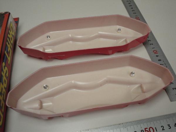

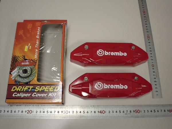

here ya go...light weight and cheap Brembo's
I can't believe anyone in their right mind would buy those. A rice racers dream. heheh
