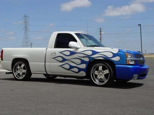

just make sure there's enough clear after the wet sand in the middle to never go through into the sanded clear. If you break through the top coats into the sanded area it leaves an image, and you'll be re-painting or spotting to fix it.
About four years ago I went through on my first paint job. I stacked it up to "oh well it was my first" Took forever to fix. Kandy doesnt act very well when you try and recoat it. All in all it was a good start. I havent gone through again, knock on wood,lol.
Heres my first paint job and buff job.
