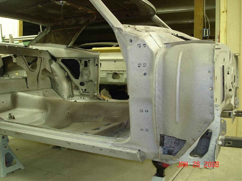

My '69 Firebird is not a rare car. It's only a 4-speed air car. At first I wanted to go back original and maybe upgrade the heads, carb, etc. But as time has gone by the vision in my mind has change over and over many times. It's difficult with so many options out there. At the moment mini tubs, a 4-link, and putting the original engine aside is part of my vision. I bought my Firebird when I was 15 years old (and that was 27+ years ago). I figured that I should build it the way I want since I have no plans on selling it.
The main issue at the moment is getting the body work properly corrected (with all rust eliminated) and to get a very straight car.
Is there an inner structure in the roof that would hold rust? What is everyone's thoughts on my top part of the window (see photo)
Thanks.

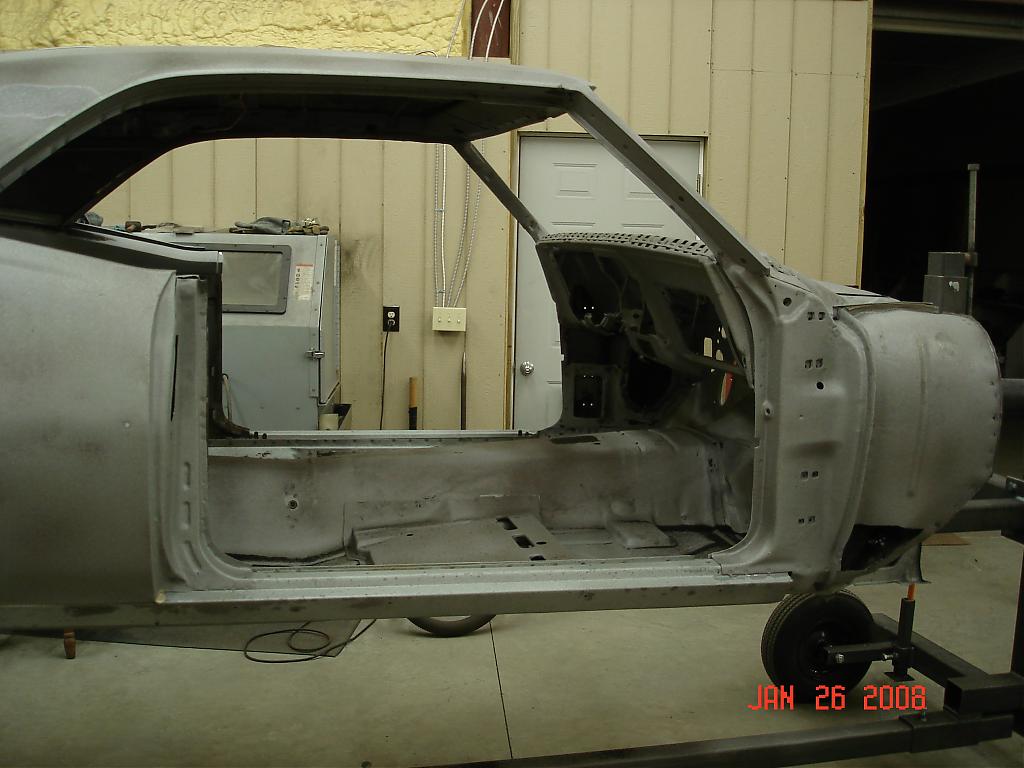

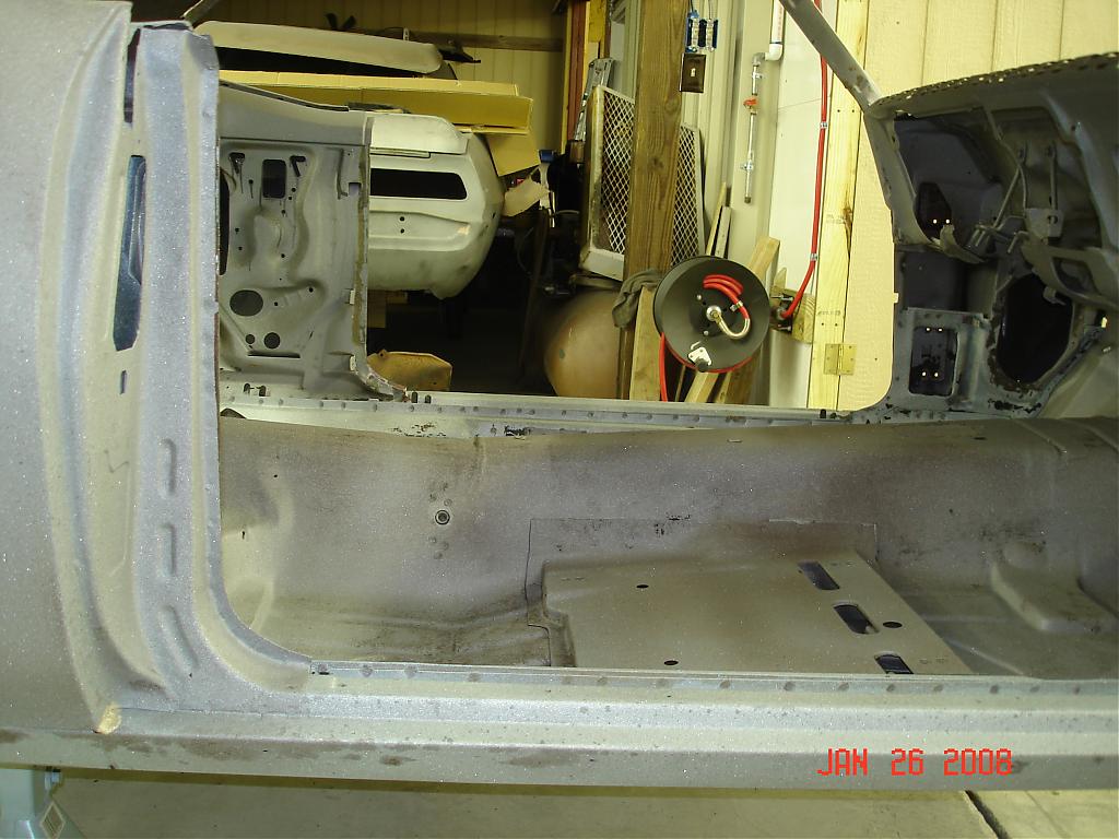

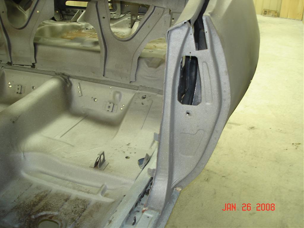

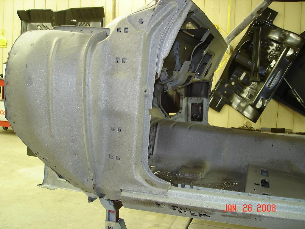

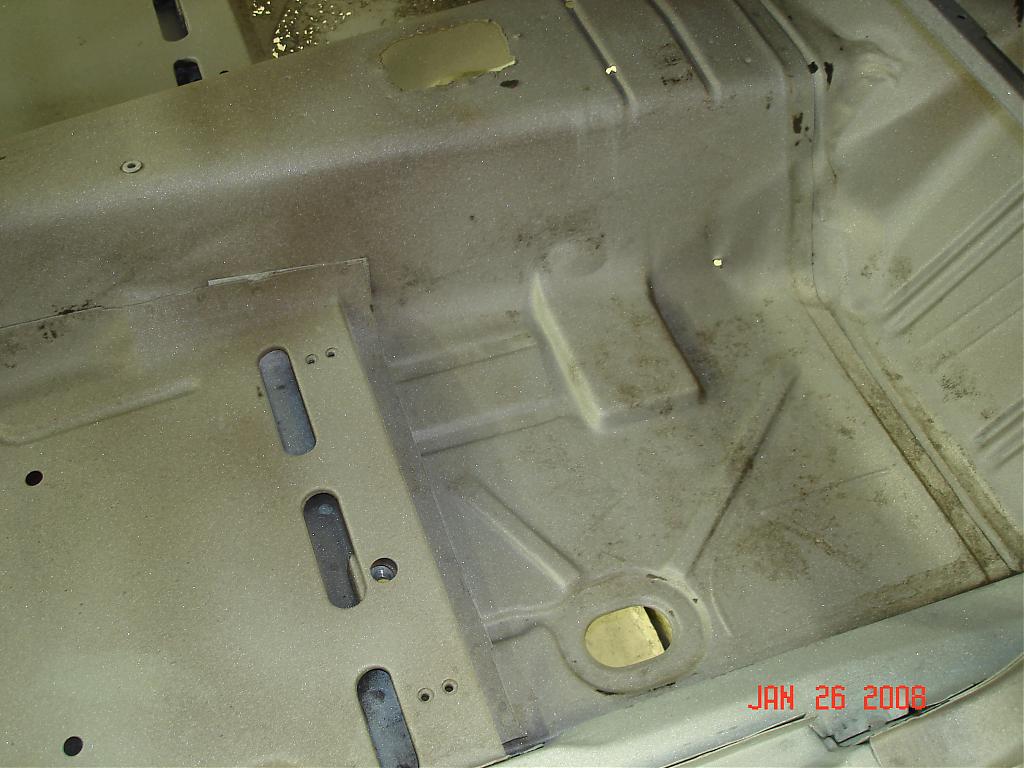

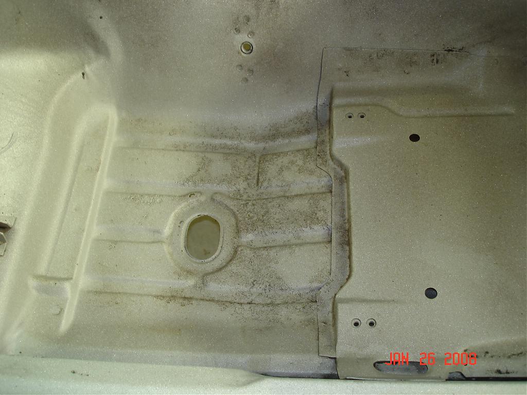

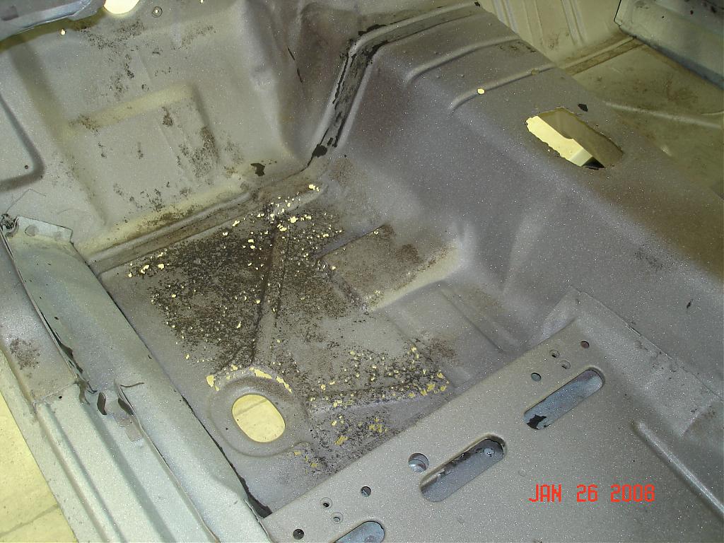

With my floor the drivers side is the worst (I left the window cracked on hot days). The passenger side is not bad. (See Photos) Both sides could be patched but I do not want any visual signs of patch panels from underneath. I know most people are not going to get on there hands and knees to look under the car but I will know its there. (crazy huh?). Also, I am thinking about painting the underneath of the car Gold.

As far as the floor goes, mine was in much better shape than yours, and I still replaced the entire piece. I, like you, didn't want any visual weld seams.
Sounds to me like you'll be replacing the full quarters and full floor! Now, just take the plunge and do it. You won't regret it.
