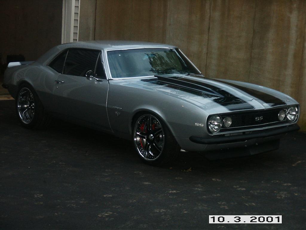

Great way to get the minitubbed look without the minitubbed cost! Deep dish looks great.

You nailed the stance and look of your car. Im going to be replacing my rearend in my 67 soon. I would love to set my car up like this. How much did you have to shorten your rearend if you dont mind me asking? and could you give any details as to what else is involved. Your car is awsome.

How much did you cut off your rear axle to get those to fit? I think it looks great by the way. Do you have a picture from the rear? Did you list the tires size and type you are running front and rear?
I'm interested as I'm not tubbing and would like some guide and how it looks.

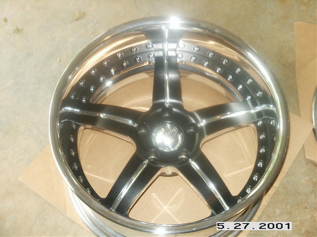

I think it was shortened 1 or 1.5 in. on each side. I just called Prodigy Customs and told them what backspace I wanted and he cut my rear to fit. The wheels are 19x10 with 4.5 bs. I am running 285/35/19 rear and 245/35/19 on front. You will have to roll the fender lips to get this to fit. It has a Prodigy Bar and QA1 coil overs for the stance in rear. Give Prodigy Customs a call he can get you everything you need
