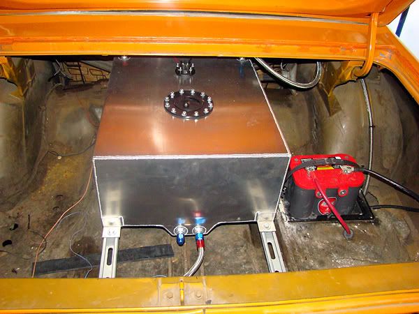

Originally Posted by osdmike View Post
Works for me!
http://www.pixbox.se/pic_show_id17149491.html
Also see pics on left .
Wow.. very nice box! Love the Aluminum.
I'm not quite there with my TIG welding yet
but that looks great!

Hmmmm,..........the bracket is not aluminum.
Just the box around it. Not TIG welded either.
I think I added approx.14lbs on the bracket/box, so if You want to cut some weight,aluminum is the way to go.
I really needed more space in the trunk for spare tire and stuff.
So this will do for now.

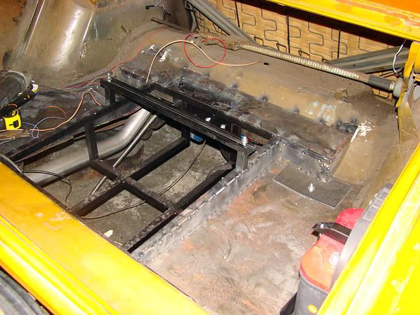

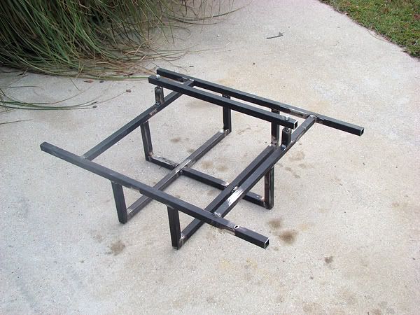

ok... heres what i came up with, its not done, and the work is nowhere
near the level of some of the stuff on this site but at least the car is drivable again, lol
First off I was always ashamed of the trunk, so i decided to do something about it
It started off with a crappy plastic fuel cell, and the top was bowed in from the heat in the trunk
Then the just as ugly mounting of an aluminum cell
Well start cutting
build a cradle to tie into the frame and mount cell
fit it all in and add some new sheet metal
and almost finished.... car is at least drivable now
I also lowered the front today, it was a bit too high, think the stance is alright now

Posts: 3,683
The trunk looks WAY better! And the stance looks great too. Nice RR!
STFU!!!!! Your trunk area and tank mount is better than many I have seen, UMM!! Hell!!! The one in my garage. Great work.. JR
