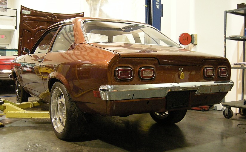

Jeff, what is your solution for the truck intake being so tall and the hood so low? Are you going to fab a scoop of some sort for extra room or will it all fit under the stock hood?
  #14
Old 11-29-2009, 05:54 AM
jeff s's Avatar
jeff s jeff s is offline
Supporting Vendor
Location: Chicagoland
Posts: 478
It's not a LS3 it's a 5.3 Alum block. I picked it cause it was cheap and light, 100lbs more than the original alum 4 banger.
If you look at the pics of the engine, it has a LS1 intake and water pump which will fit under the hood. I bought the LS1 intake and 2 other spares off craigslist for $35 ea.

Got the s10 spindles, brakes and 8.5 rear end in it.

Engine went in for good today. Pics later
