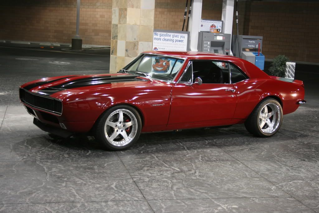

The wheels are iForged "Astra" 18x8 front (5.00" backspace) and 18x10 rear wheels (5.50" backspace) Nitto NT55 tires, 245 wide fronts, 285 rears.

Your rear end is only lowered 1 1/4'' with the CAT-5?

At first it was about that. After it sat for awhile it was more like 1.5 to 1 3/4".
Here's a list and the part numbers for everything I used.
GW Tubular upper control arms w/ del-a-lum bushings
CTA-79A
Lower control arm del-a-lum bushings 1013
L-2CAT5 performance leaf springs (road racing shackles included)
GW Mono to multi leaf conversion kit 1035
DSE stock lower shock plates L/R 040302R, 040302L
Stock Replacement U-bolts 7/16" 20x6 3/4 w/nuts 040703
Curtis
