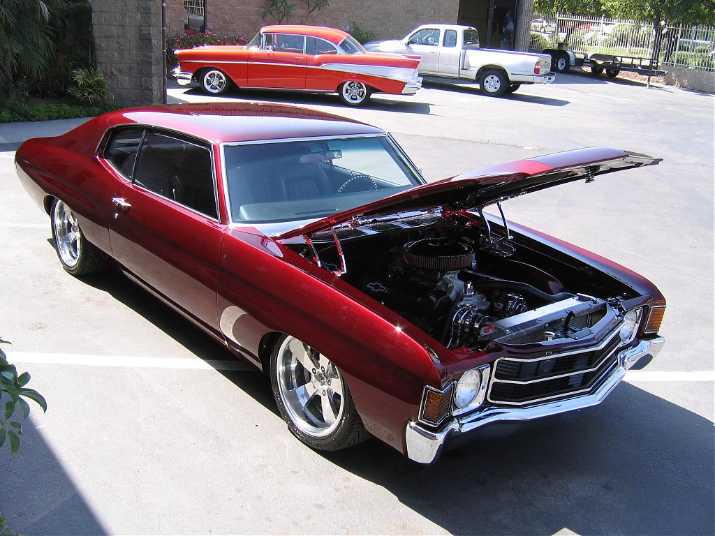

18x10 With A 6.25 Offset 315/30/18 Pilot Sports And 18x9 With 5.5 Offset 275/35/18 Up Front On A 72 Chevelle With Airride
Beautiful color...Huntington's,no?
