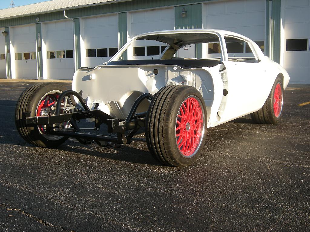

This TA will be for sale. As soon as the Divorce Court Judge rules on it.
We also have a bolt in full frame chassis available for 2nd gens and 15 other cars. Which this car already has in it.
It's also been minitubbed and painted.
Call if interested 815-206-2230 as I haven't had much time for boards lately.
