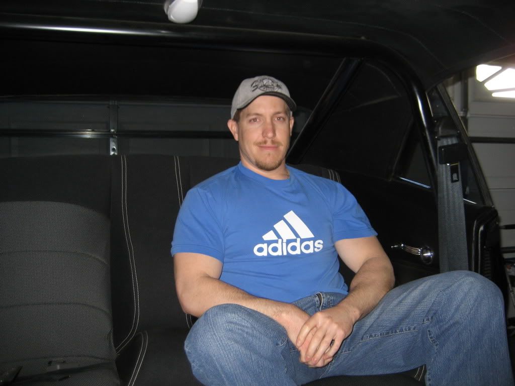

Alright guys, this is the best looking model I could find. I'm 5"9 and my hat is rubbing the ceiling. The roll bar is within 4-6 inches of my ear.
Wow...if the car went sideways...got hit - turned over (in normal city driving) - that would HURT!

Todd thanks for the picture, there is noway thats going to fly with people in the back seat. I guess you go to a 2 seater or you forget the roll bar.
