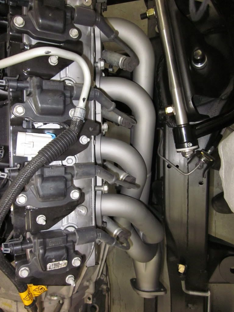

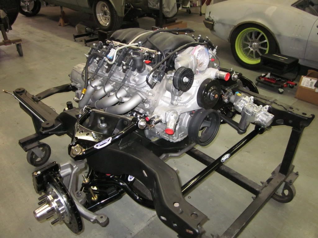

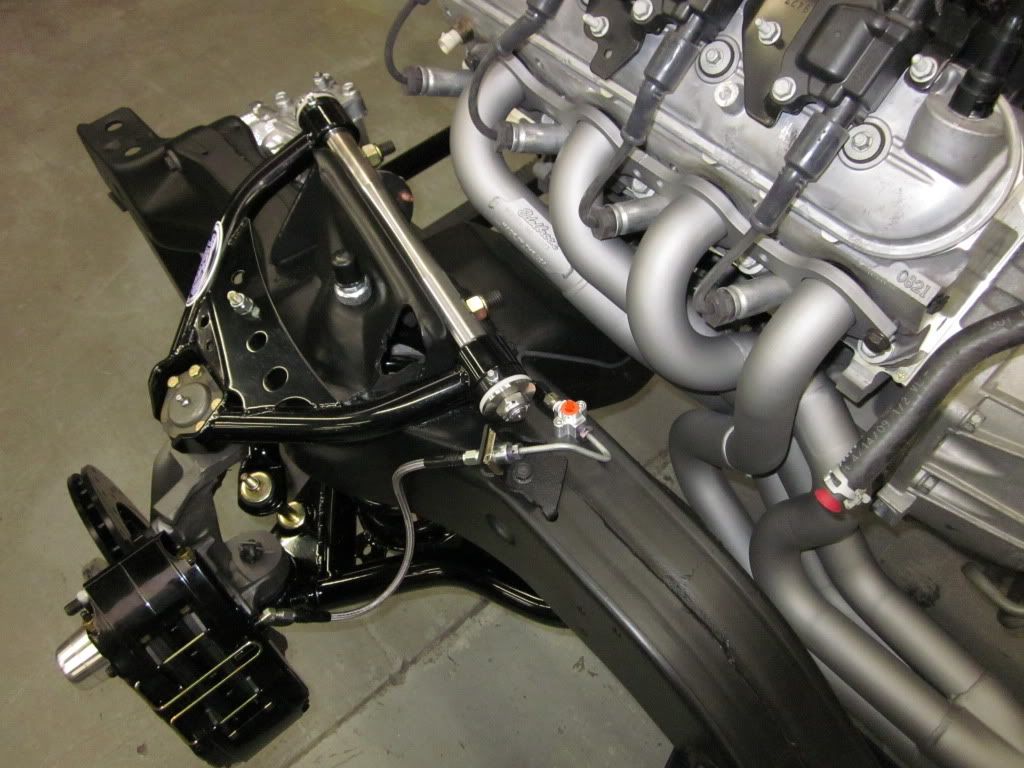

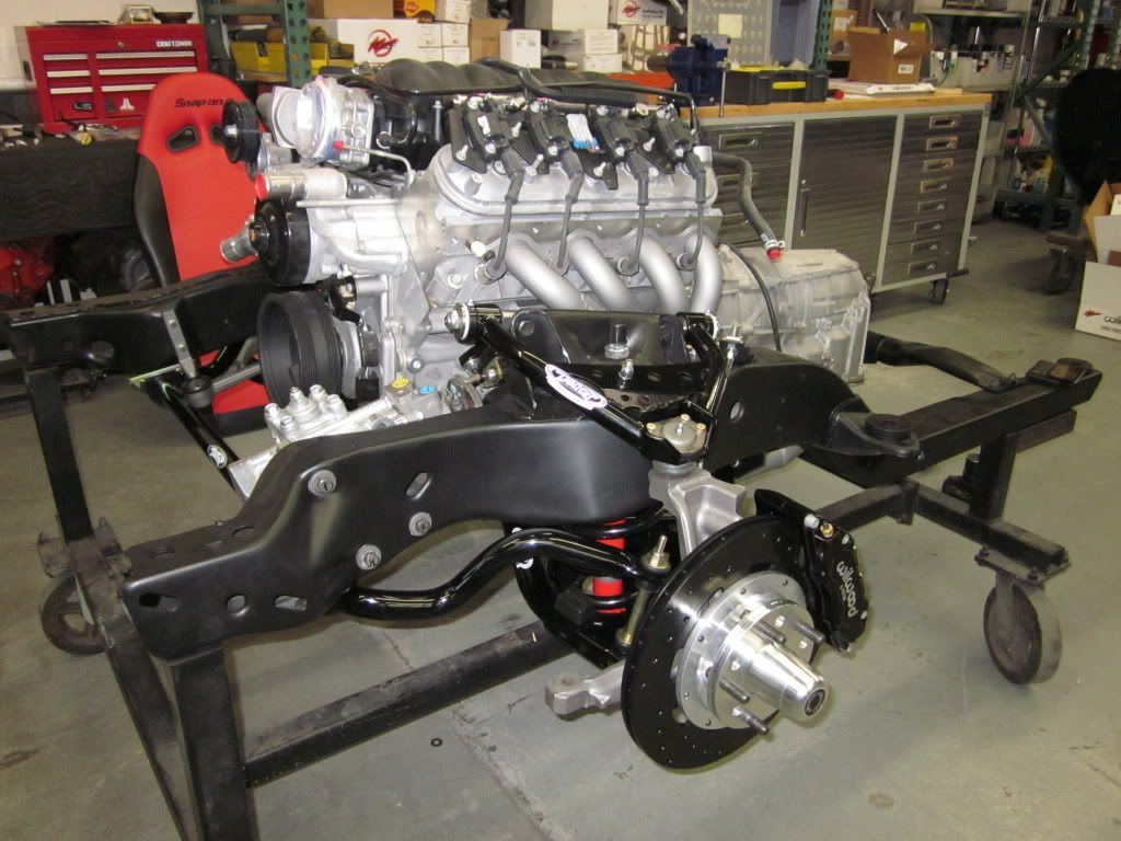

it has been a while since I have had any update on this build.. owner decided to do a few suspension upgrades.. Detroit Speed Stage one suspension upgrade with gear box & Wilwood brakes on all four corners..
We used Edelbrock headers & they fit nice!!
Cris Gonzalez
