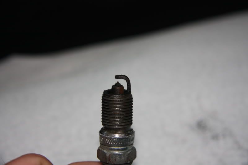

ok so heres what im working with plug wise. would probably be wise to change them anyway but do you think these little guys would be my source for not starting?

Plugs are fouled, check for spark and replace them. Make sure the choke doesn't close all the way.

You can buy a spark test tool at any automotive parts store. You will connect your plug wire to it and then ground the other side. When you crank the motor it will either spark across a gap or light a bulb (depending on the type of tool) if you have spark. You could also do it by leaving your plug wire attached to a loose plug and lay the ground strap of the plug on a good ground. Crank the motor over and see if it sparks. Dont hang on to the plug while doing this because you will find out really quick if it is sparking.
Did you by chance check the ignition fuse?? I know it might be a stupid question, but something easily overlooked.

If it sat that long your fuel has gone sour... and obviously your plugs were fouled...
I ALWAYS have cans of starting fluid around - they're the cheapest thing a car guy can have - a squirt or two of that in the carb (don't even need to remove the filter) and if it doesn't fire IMMEDIATELY with that - then you have 'other issues'. Using starting fluid is WAY easier on the battery - since if all else is okay - she'll fire off - and it tells you what is or isn't working. If it doesn't fire with starter fluid - you've got not mister sparky.
If the gas has gone bad - then firing it off with the starter fluid gets just enough heat and compression going - that sometimes she'll keep running.
If you're going to let gas sit that long - be sure you add some type of storage / fuel saver (whatever brand you have)....
