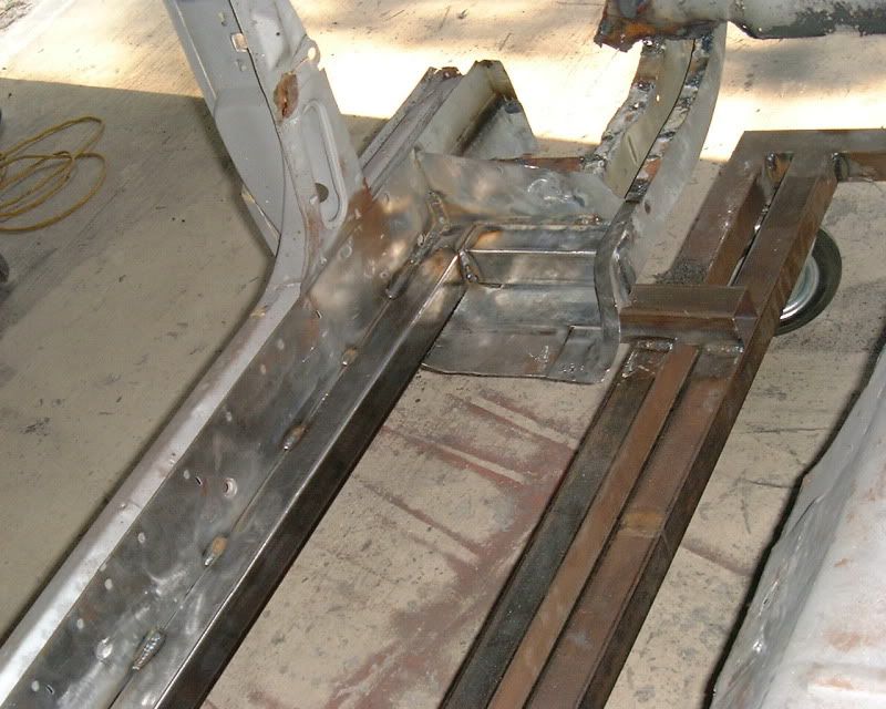

Brian cut the floor out next step will be subframe connectors.

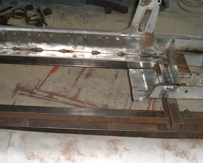

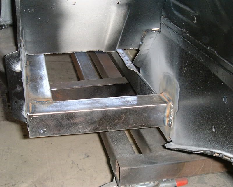

This afternoon Brian starting making the right subframe connector. Since the early Mustang has no torque box in the front we are making one out of 2 x 2 and also welding it to the rocker and the rear torque box. He still has to finish welding it to the rocker

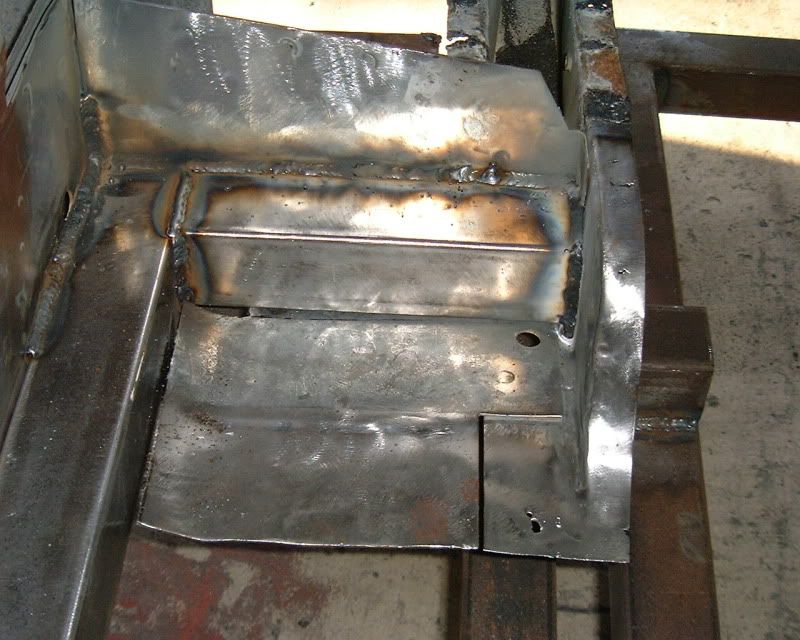

Brian finished welding the rocker and added the top of the rear torque box
