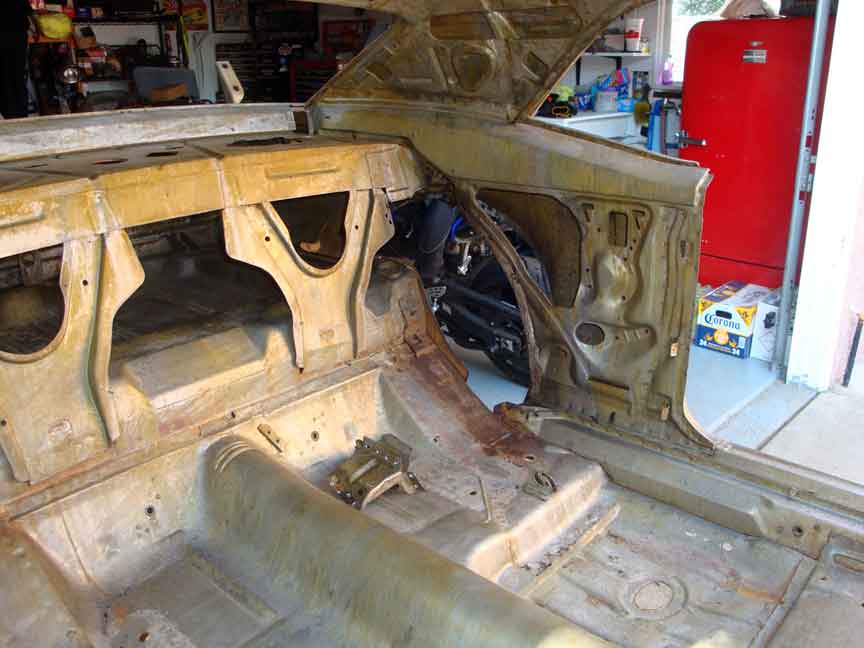

a few more pics...

I personally would not bother with dipping my car.
If i were you I would just have is blasted (media, or sand) just don't hit the sheet metal that you plan on using.
Also sandblast as you take your car apart (when you take a quarter panel off)
just my .02

Looking good; in the pictures, it looks like you're just dealing with surface rust. Have you tried a wire wheel? (At least on the underside).

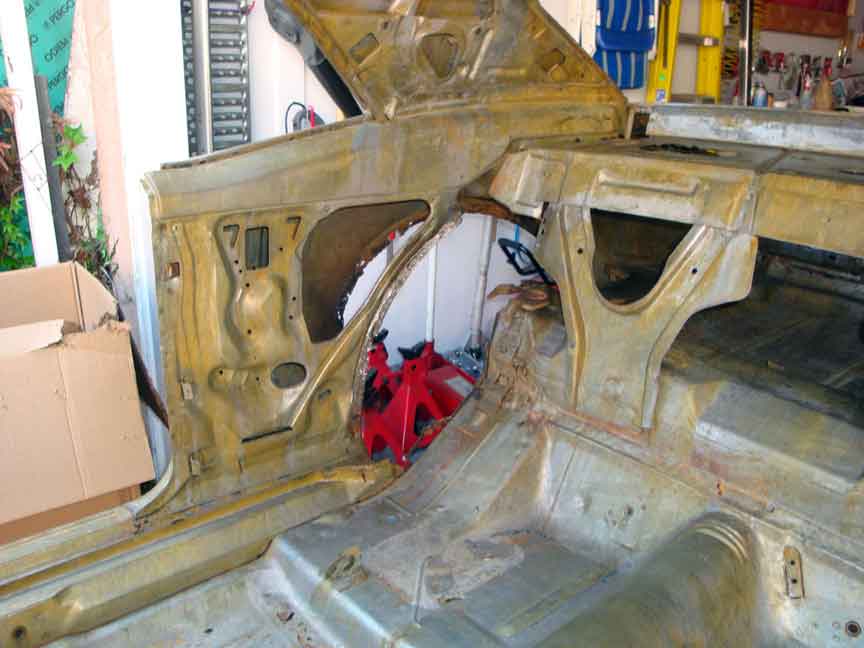

Thank you. The dipping process removed most of the rust, but it's still in the cracks and heard to reach areas. This is why I was disappointed with the dipping process. Being submersed in liquid, I'd think that it should reach to just about every area (except for metal that is pinched/ welded together)
However, I'll be replacing and modifying a lot of panels, so I should be able to get to any remaining areas not cleaned already.
I'll use a combination of methods to remove any remaining rust.

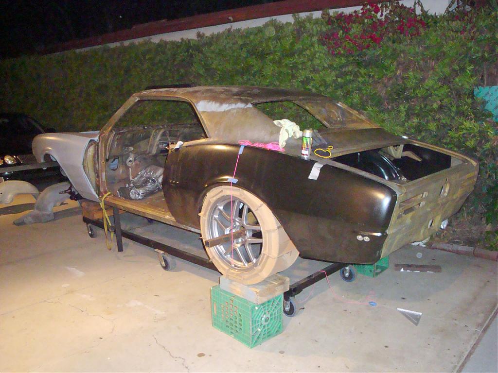

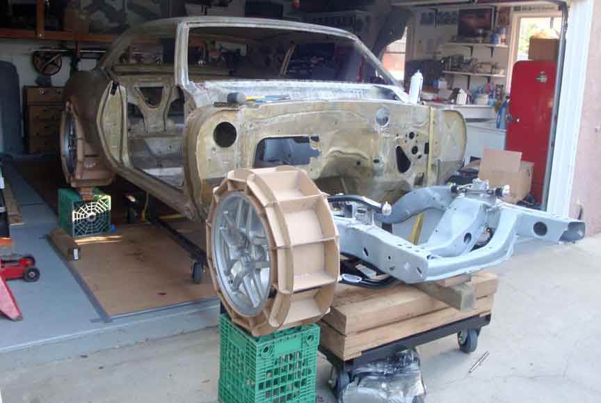

This weekend I had limited time to work on this, but I think I made some progress. I don't have the tires I want yet, but I do know the size and overall dimensions, so I mocked up a set in cardboard as place holders. I had plenty of cardboard leftover from my goodmark panel shipment, and this is light to move around.

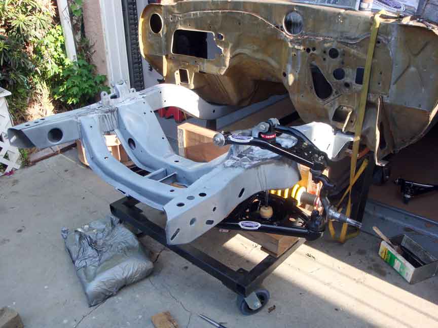

I also started to install the front suspension for mocking up purposes. I understand that with the DSE suspension/ stock frame there is a wheel width limitation of 7". Although I mocked it up. I'm not exactly sure yet what the limiter is as I don't have my hubs or brakes yet (I can only guesstimate where the wheels will truly sit. ) If anyone has had any experience with this please chime in where the issues are so I can address them.
I also placed the back wheels in, and was happy to see it start to look like a paddle boat- I mean car again. Since I need to replace my quarters and mini tub the car- my neighbor had a good suggestion of widening the back body a bit. This will help maximize track width while keeping the tires inside the body. We mocked up a qtr panel and it looked good, but I apparently didn't get a pic of it, nor the car with the front body panels on.
