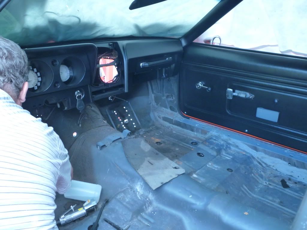

Didn't get to much done today, just got the seats and carpet out of the car and cut the front end off.
