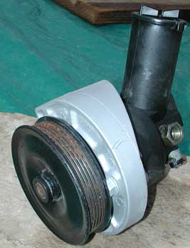

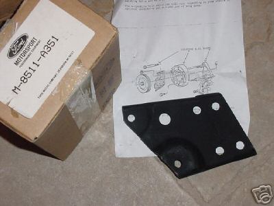

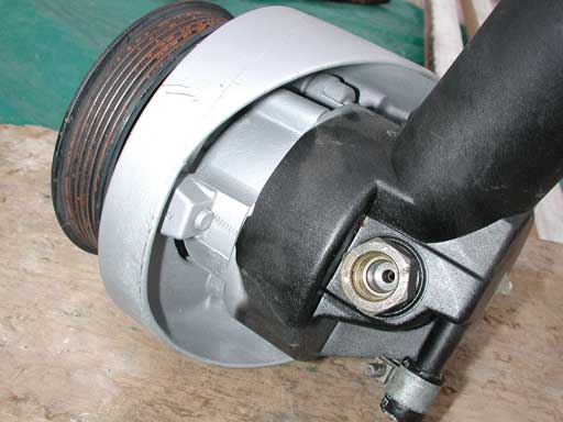

I have a Saginaw pump, (see pic 1), but I want to mate it to the bracket I included in the previous emial. (See pic 2 & 3). I need to find out if that horseshoe bracket will do the trick.

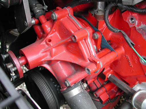

As for the H2O pump, you can see by pic 4 that there's a challenge ahead to line them all up. The aftermarket billet pulley was offset a good 3.5 inches, but I don't dig that arrangement.

Yes, that horseshow bracket will do the trick, but the only way to get your hands on this adapter is to buy the Cardone Super Pump. That particular aluminum factory pump bracket will definitely need to be mowed in various places to clear the stouter Saginaw P, though it is well worth the effort in the long run.
