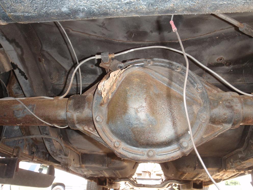

These are some pictures from when i brought the car home before I even had a chance to clean it up. The car is rust free minus some minor surface rust. I bought it in NC the frame is solid from what I can tell. Sorry about the poor quality pics Im currently away from home training.

Looks like the rails are killer. If your going to put any power in it you will need a rear. We can do the fab 9 housing with brackets all welded made to width you want
