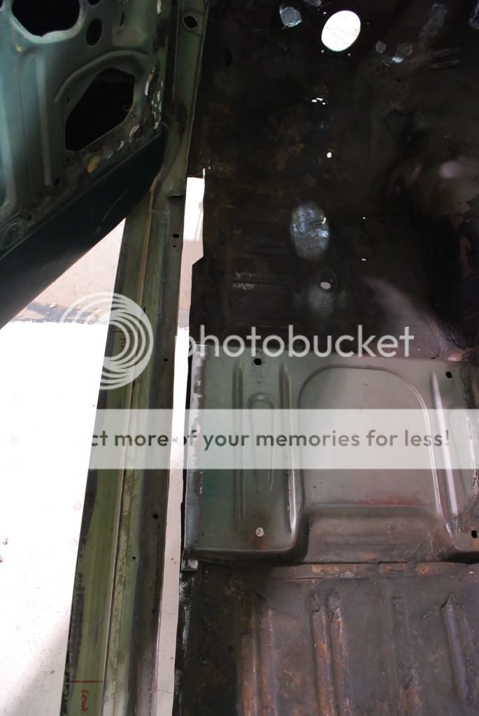

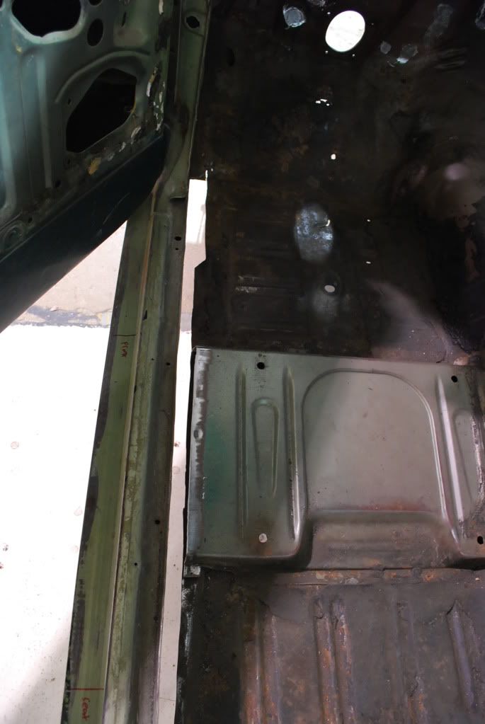

Mustang chassis eliminates the complete front inner structure. a 2" channel needs to be cut on each side of the floor along the rocker and the body then slides onto the chassis retaining the rest of the stock floor.

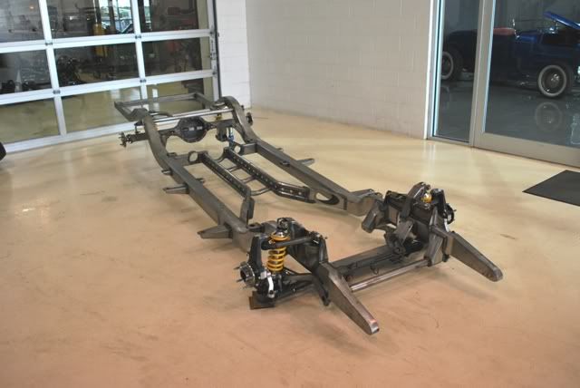

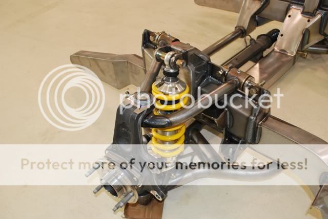

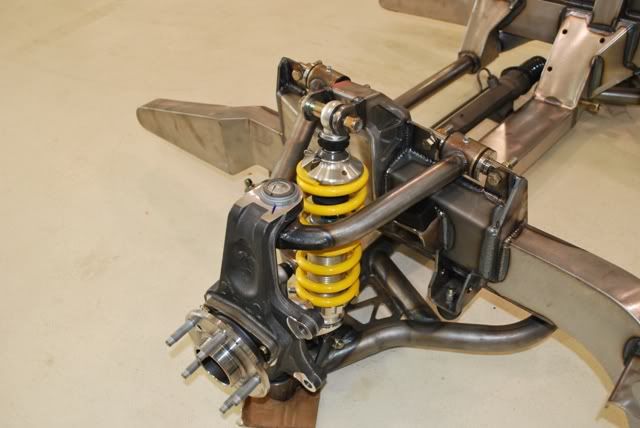

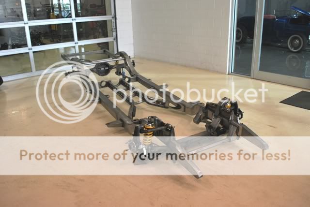

Here are a few pics of the 55-57 Chevy chassis
At ride height.

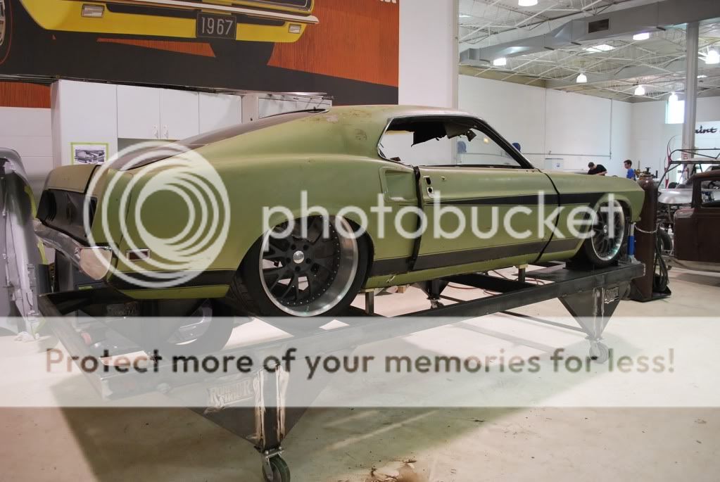

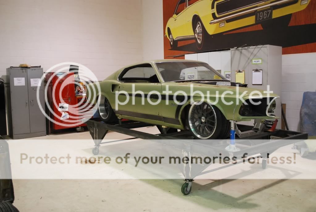

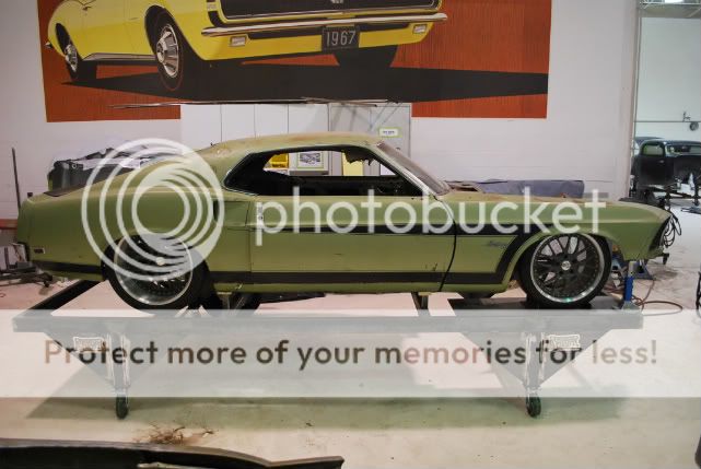

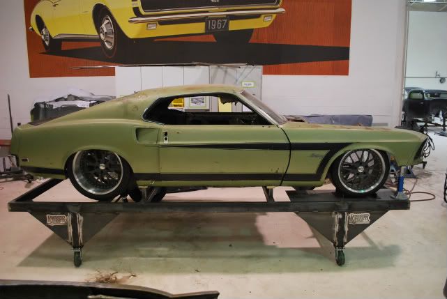

Here are a few shots of the 69 Mustang at ride height. I did not get any good pictures of the first few chassis built, but we have another going together now that should be completed shortly. I'll get pictures up as soon as it is completed.
This is the modification to the floor that is required. A 2" strip cut out where the floor meets the rocker. (Picture was taken of the driver side. Door open, shooting towards the front of the car.
