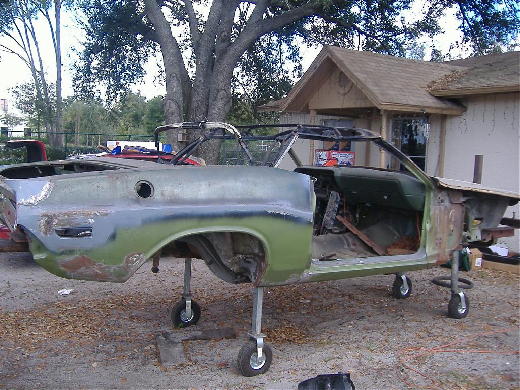

I'm still not considering cutting the rails just yet. That cross-member is 2x4 .190 & the LCA cross bars that I have are cold rolled 1.25 solid bar ( Trust me, I have have access to digital measuring tools to locate the the LCA shafts & the smarts enough to make it straight & true . I believe welding it in plus strategic location from Scott & using with his steering arms & sway bar setup I can keep my rails.

Seeing that I'm dead at work I continued with the lower mount with some help from one of our members, I decided to go with a 60.5 track.

Nice cars on their site! I don't think the tops of the Mopar frame rails are strong enough for the upper mounts. Looks like I'll have to section them & make a stronger rail in that area but keep the stock dimensions to make it unnoticeable. So much for not chopping!
