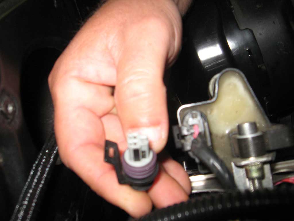

What is this? I can't find a spot for it?
oil pressure sender I believe........

I think the oil pressure senser is oval. Is it on the right front, or back by firewall? If up front it could be AC high pressure switch. All my plugs/wires were labeled from speartech.
it also looks like the older TPS plug. I was guessing oil pressure because of the location, looks like it's at the rear of the engine in that pic.

It is towards the rear of the harness by the fire wall. It's the only plug that wasn't labeled. Not knowing much I would think it could be oil because it's close to the drivers side rear. The oil pressure unit is right by the oil filter, mine is not drilled and tapped for the unit yet.

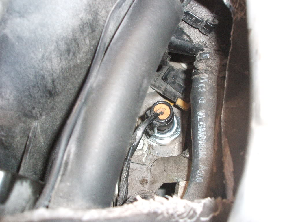

that's exactly where the factory oil pressure sender is, and it's the correct round three terminal plug. Stock on most LS engines they're right behind the intake manifold, in the valley cover plate. The LQ9 you have isn't in the cover, but the same location I believe, right next to the cam sensor, upper rear of the block. Let me find a pic.
edit: okay, here's a pic on found on the net, the second pic is where yours is; same location as the first, but the valley cover is different and doesn't cover the sender........
