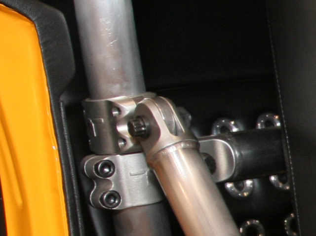

here are the clamps im thinking of using and i dont think these will squeak.
also, im not one of the experts, but looking at the significant structure we would be welding to, along with how the factory has it done, i cant see needing all of what dse did. look at the upper belt holes in a chevelle, or the holes in the floor backed by a plate and youll see what i mean.
my plan is to solid weld one of these ends to a 3/16 plate and then insert it from inside the quarter and poke it out into the interior. i will then slide another piece of 3/16 over the exposed piece and plug weld it through the sheetmetal into the 3/16 piece now inside the quarter. i dont think it will need much more.

you're right, those connectors look nice and beefy, would definitely not squeak when screwed tight. much better than a simple drop pin.
only concern would be one side of the connector is going to be permanently mounted to b-pillar and would be kinda knarly to catch yourself on getting in and out of the back when the harness bar is not in place.
