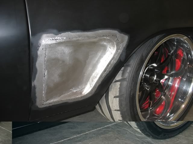

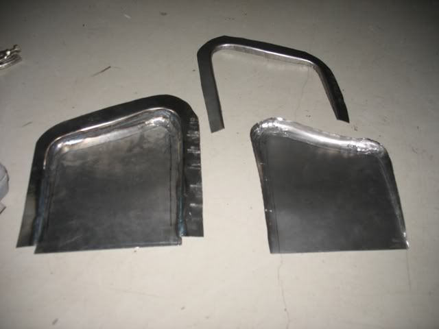

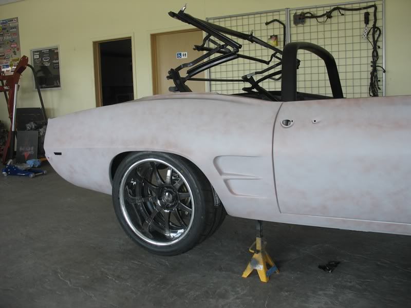

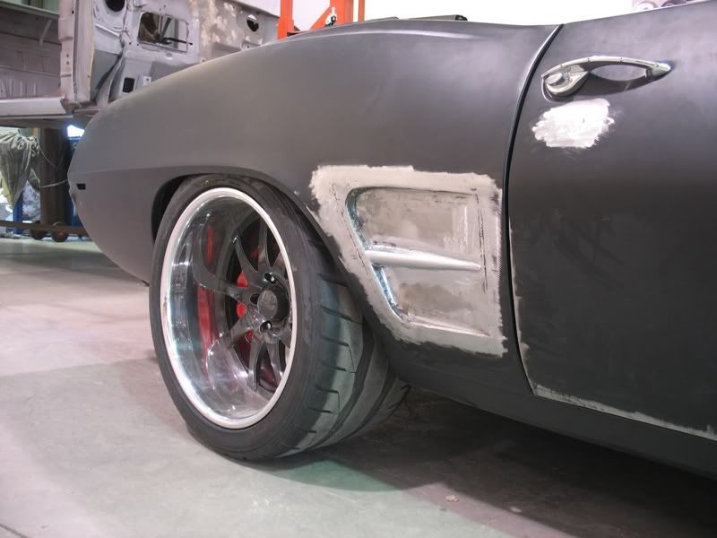

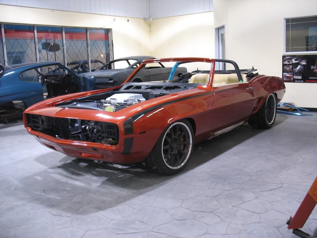

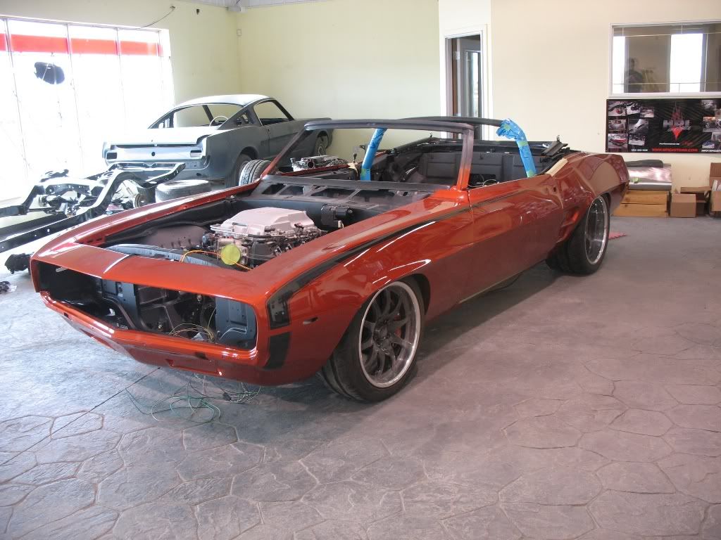

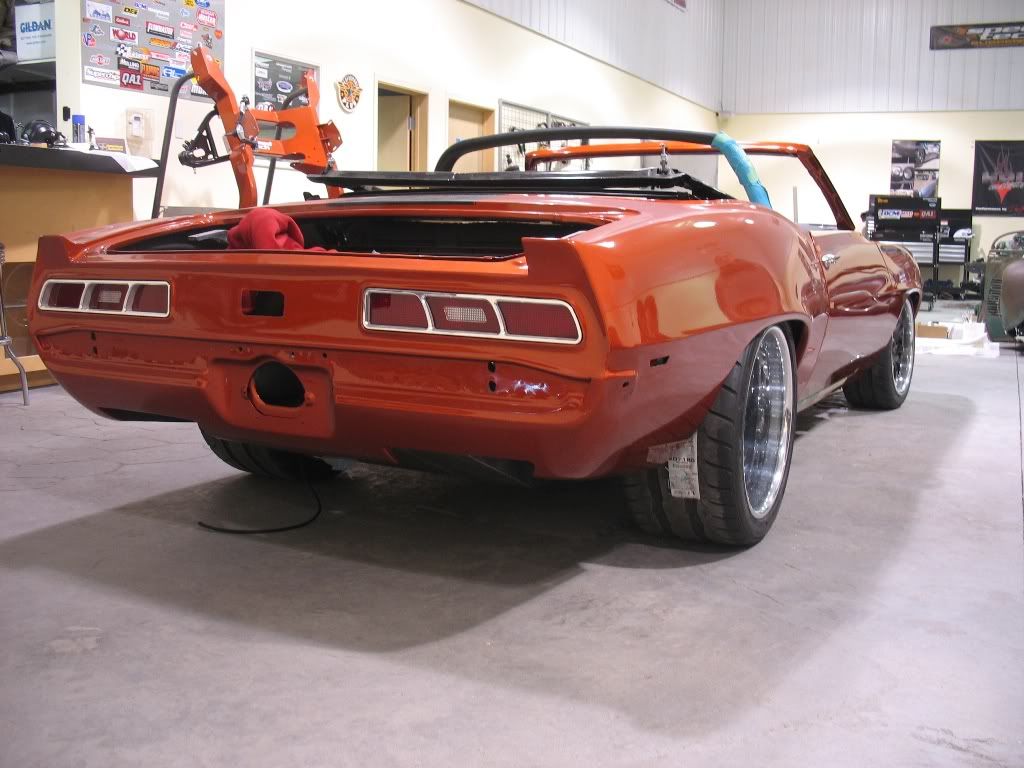

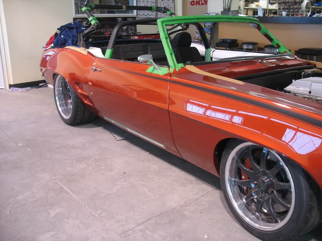

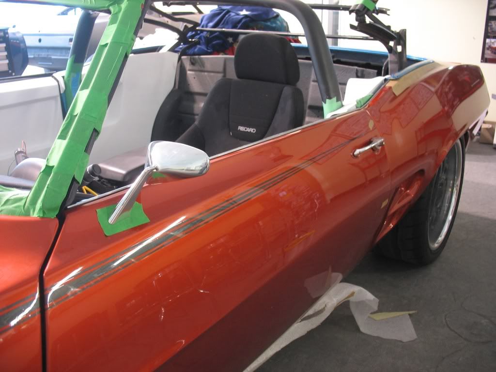

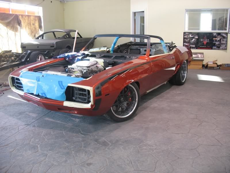

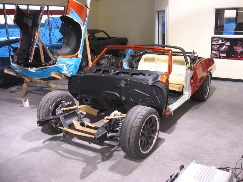

Ok so I openend up a photobucket and started taking some time to put pics on.... lets show you some of the body mods we have done! Starting with the side vents (so they are not really vents, just styling, because to actually vent the brakes we would have ducts where the rear seat should be, as this thing is running 335 nittos and the new dynacorn mini tubs that we installed, which are not really mini! 3 3/4 inches over stock, and they look stock and fit great. Plus we didnt want water and crap flinging up through a vent onto the paint.... I don't know that the owner of this beast will actually drive it like we will.
Formed the sheet metal, flushed it in, added spears and bingo! I actually made a wooden form to fold the two pieces into their shapes then tig'ed em together. you can see the new (ok well new at the time when we got them, but old news now i guess) Ring brothers handles, shaved lock holes, and we deleted the rocker/quarter seam before filler and primer. More to come on the oval/arched styling bar!

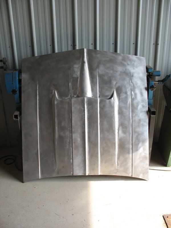

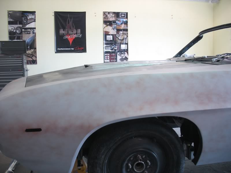

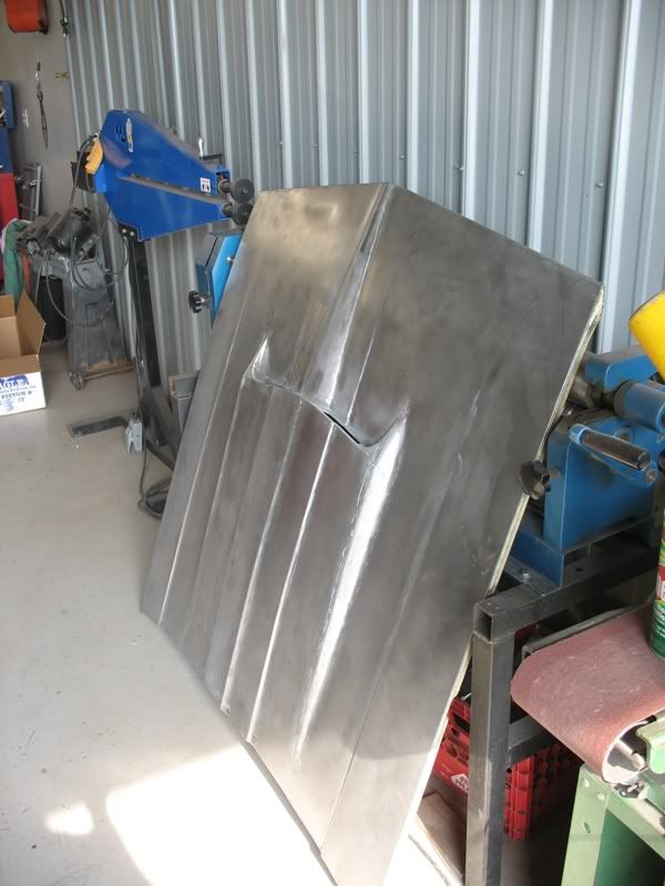

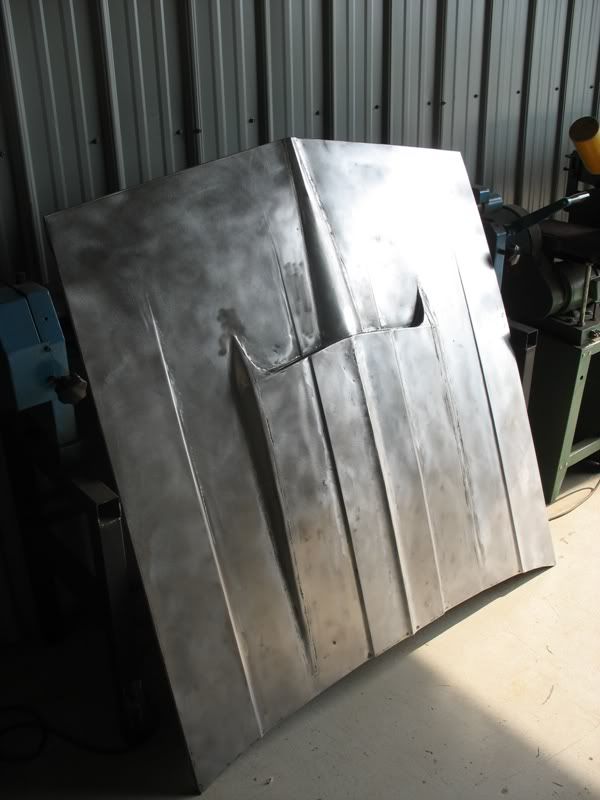

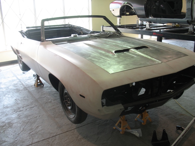

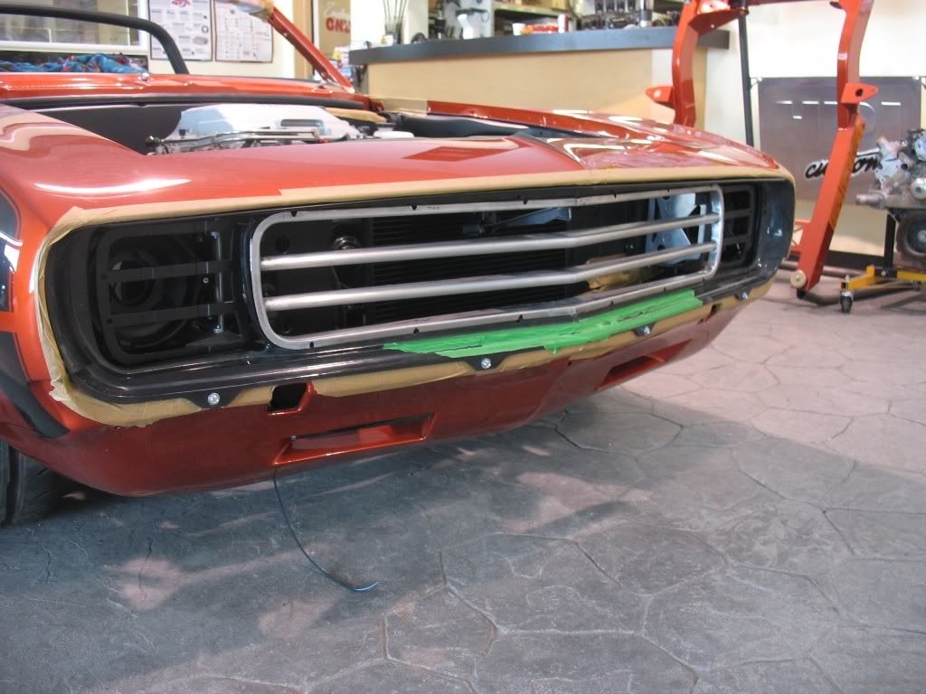

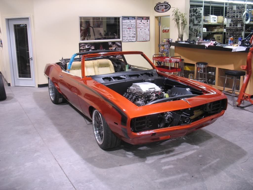

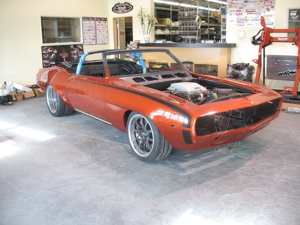

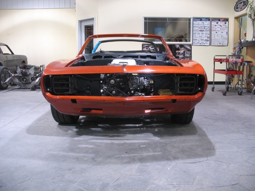

Ok, on to the hood....... I know that some may not like it, the customer wanted the fiberglass stinger and I figured he has too much moneygoing into this to have the same hood as everyone else....
So we made the front spear the same as the side vents that we made, and went with a subtle height and we will have some billet vents in behind it. As it is efi, we dont need a scoop really. Also, I hate how most of the cowl hoods and the stinger hood dont have the body lines from the wiper cowl in the hood, only the one peak. So we wanted the hood to roll out of the wiper cowl into a bulge, then back to nothing.
I think it worked well, it looks amazing with the striping on it (save that for later!) Its truly one off... even the bracing underneath we tried to finish off so it looks factory ish. The hood is made of 4 pieces and a stock hood, plus our two vent tunnels that are one piece each.
