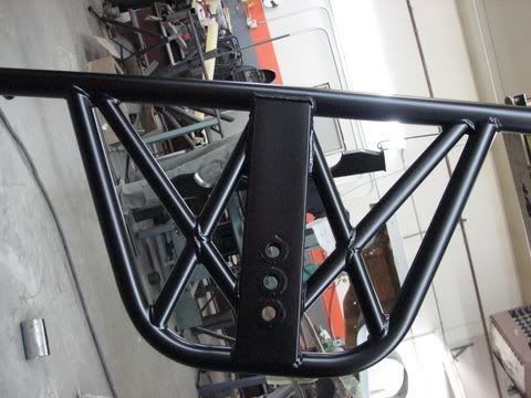

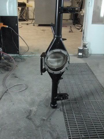

My DSE goodies arrived yesterday!
And Jake sent me a few more pictures of the completed rear end housing and Watt's Link mount:
