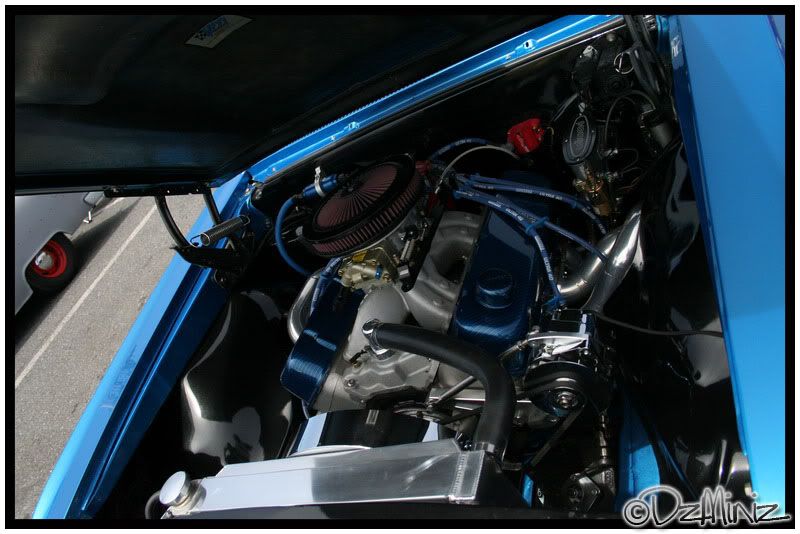

those headers are the best thing ever for a big motor chevelle. we got em on our 66 with 2.25" primaries and they fit outstanding. no problems with leaks whatsoever with just regular header bolts. didnt like the copper gaskets so plain old felpros do the trick. just be prepared to cut the inner fenders out alot to clear them.
best picture i could find.

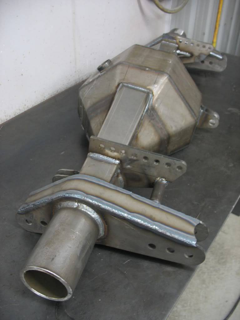

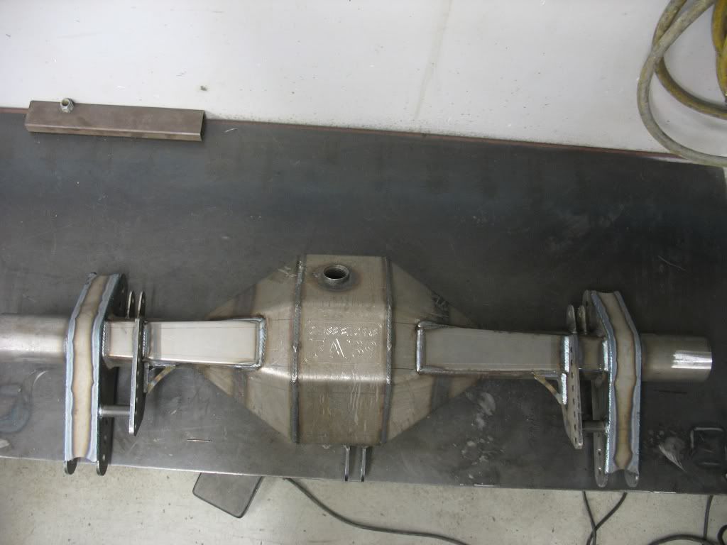

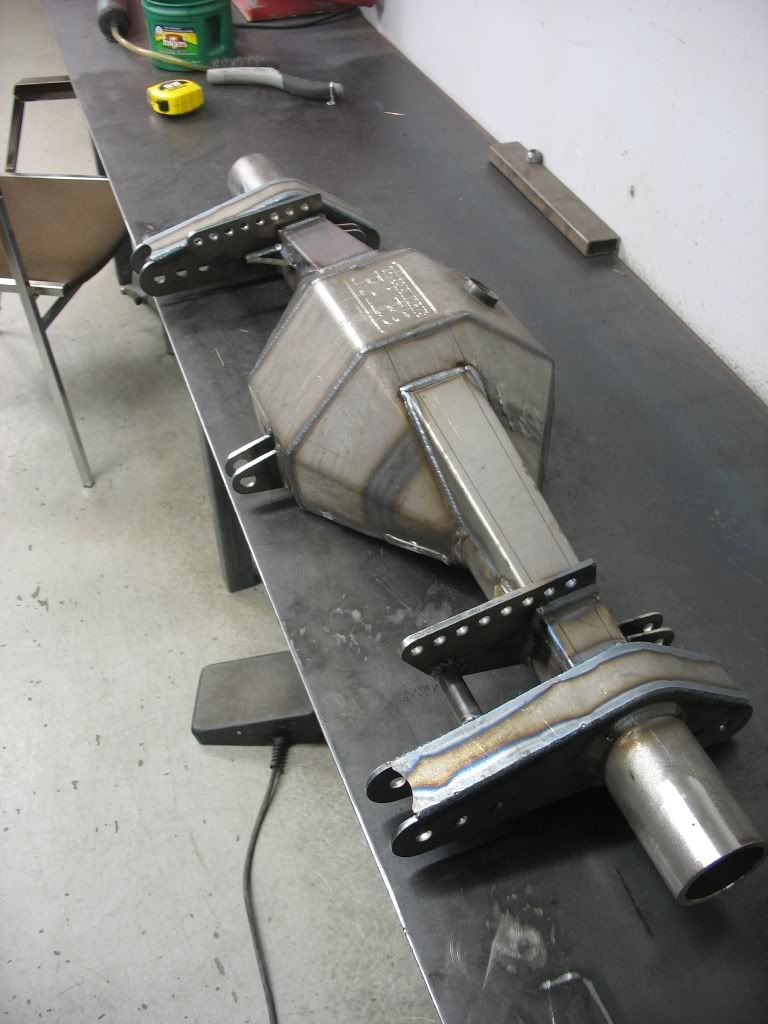

Got most of the rear end finished today on the Chevelle project. Its a Fab9 housing, with wishbone mount, antiroll bar mounts, gussets and tie down bars for trailering.
Just gotta throw it in the jig and install the housing ends!

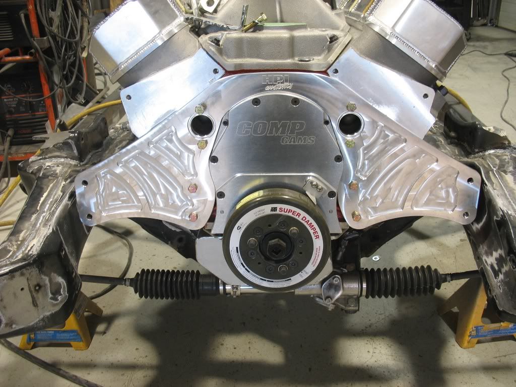

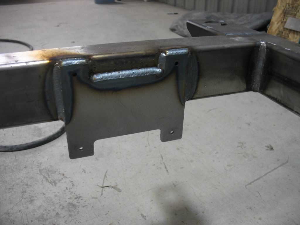

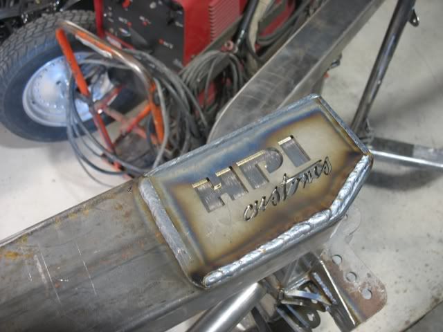

Ok here's an update! Chassis and all its components went out for powder. Here's some of the other goodies that ended up on the chassis.
Aeromotive A1000 pump mount
Frame gussets/fishplates
Front brace with integrated tow/tie down hooks, as well as the mid and front plate mounts
Custom Mid plate
And the focal point of the front end, a CNC machined Motorplate!!!! Its o-ringed on each side of the water pump too!

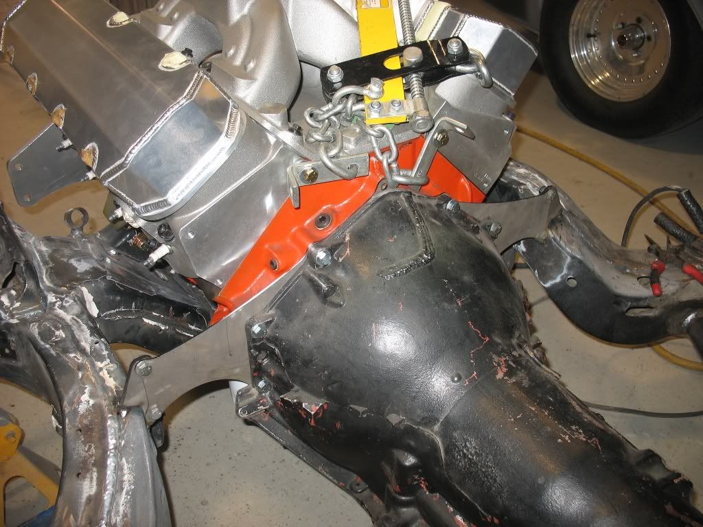

Also, Jeff if you look close you can see we added a gusset on the rack mount and changed the whole driver side rack mount. We changed the input shaft angle, and made a nice laser cut mount with gussets.
Cheers!
