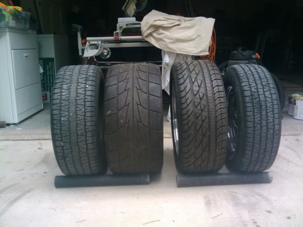

I picked up some bullitts for a good deal this morning before work. Factory Anthracite 17x8's up front on some 235/50rz17 meats and some 17x10.5 repro's with nitto 315/35 drag radials out back. The color of the repro's arent spot on, theyre lighter, more of an actual silver color. But im not worried about it. all tires have good tread and it they look that bad, Ill paint the centers black on all of them. cant wait to try and stuff them. Need to pick up new lugs, and dig out the BFH in the garage haha

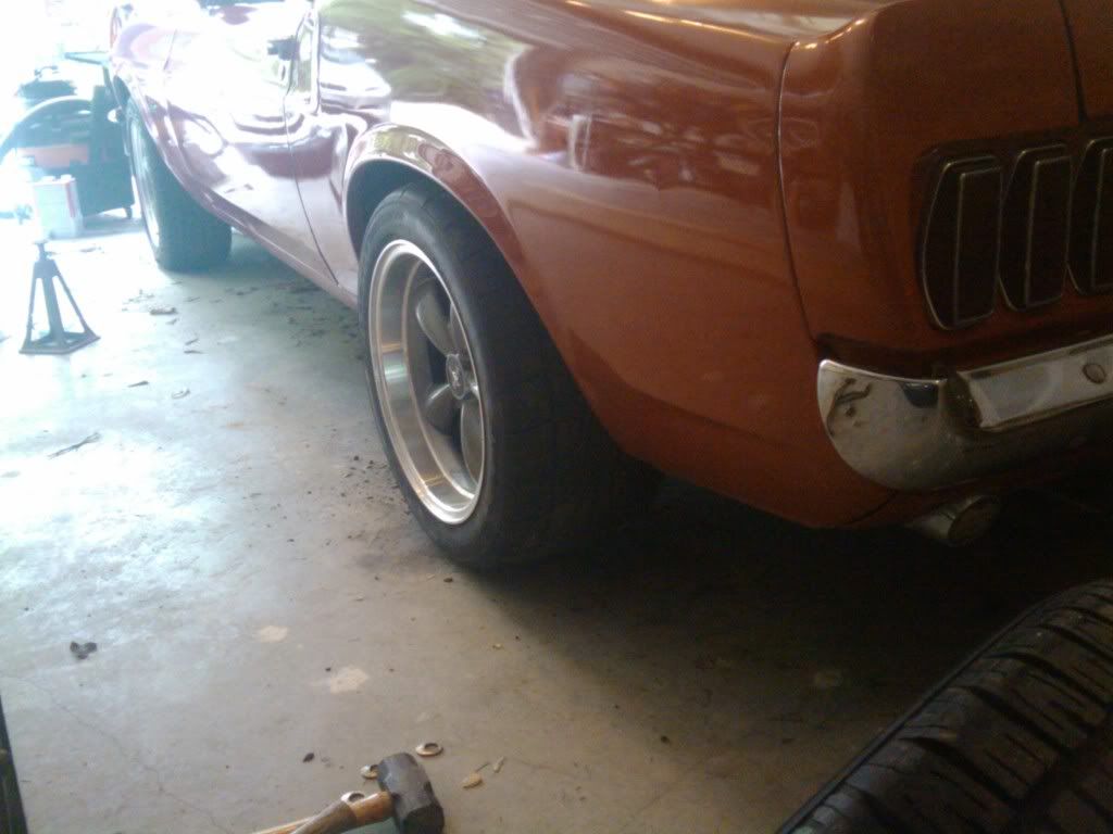

Old tires on outside/new on inside..

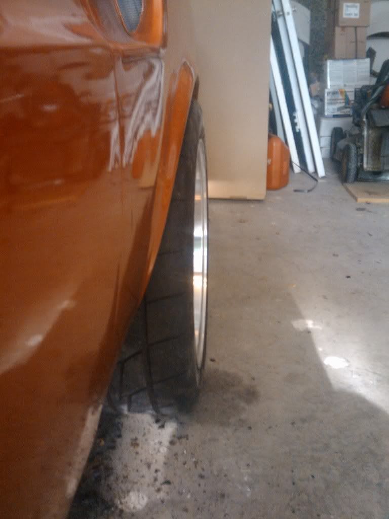

test fit one front with the 1" spacers and I think theyll work great even after I get the front end down some. Also test fit the drivers side rear using the other 1" spacer I have and it pokes out just past the fender. Have some ARP studs ordered so i can swap those out and run about 7/16". Probably going to have to run about a 5/8" spacer on the passenger side as my rear is offset a little. here are some cellphone pics of the mock-up.

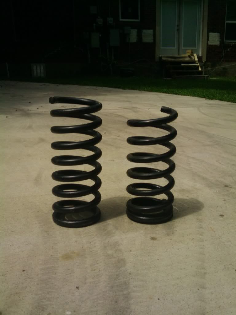

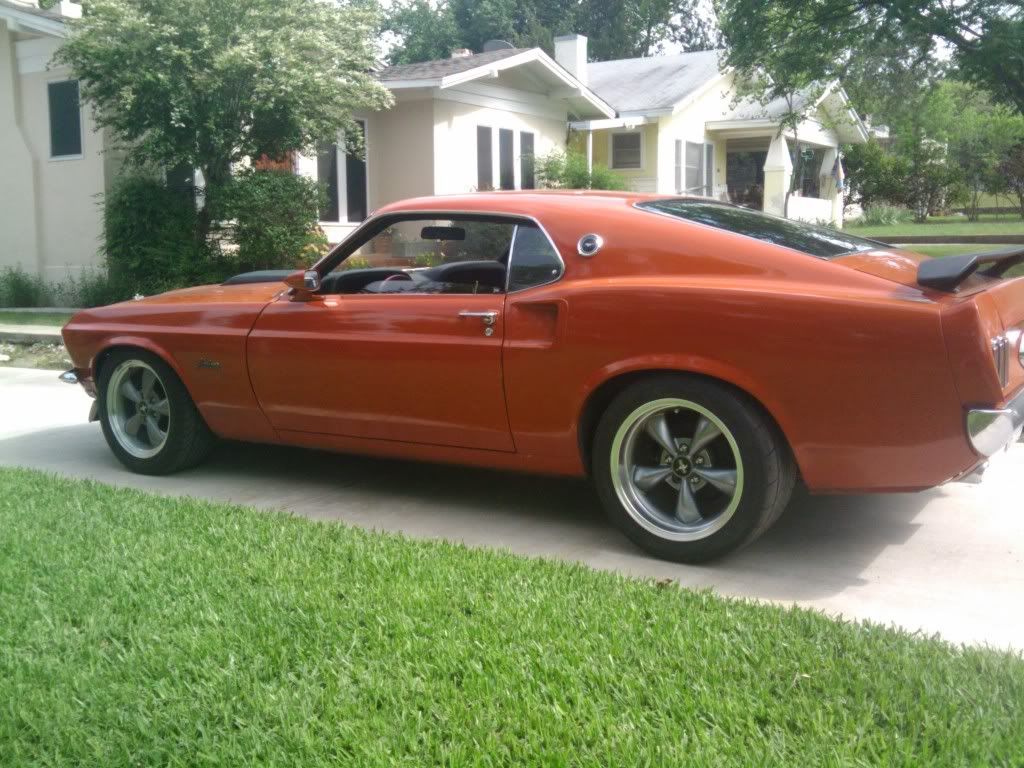

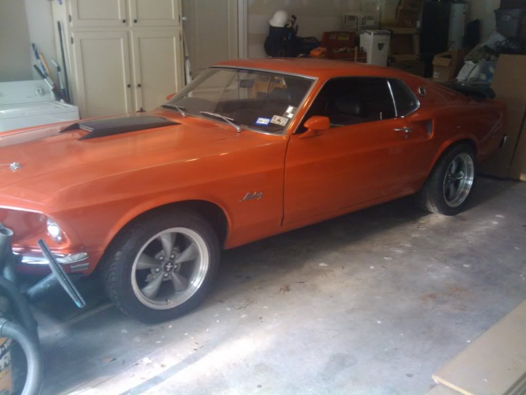

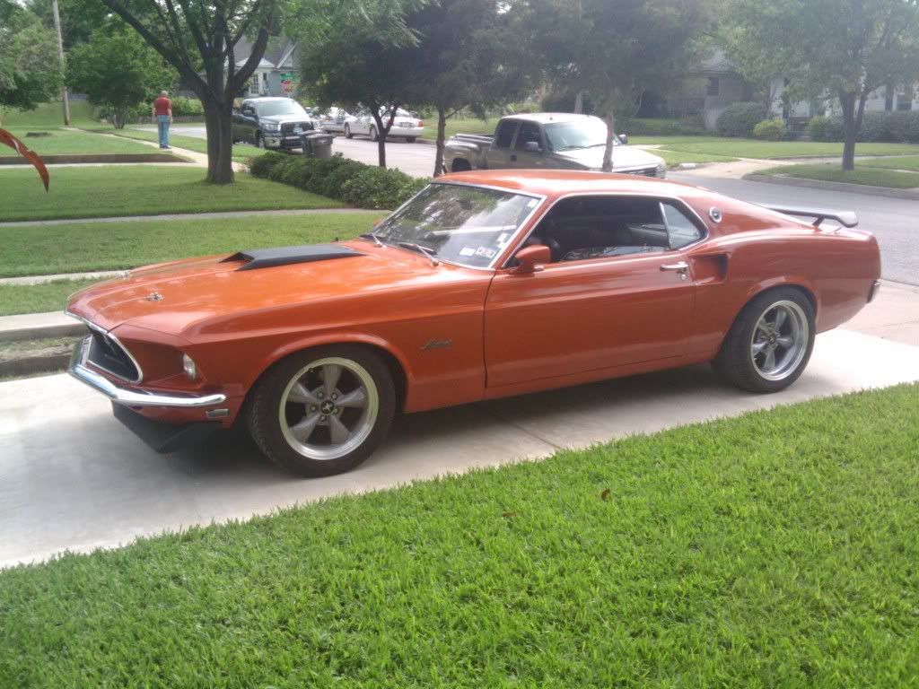

Got a lot done last night and today. got the studs swapped out. Pulled out the stock length front springs and put my cut springs back in. I had put on the 1" rear lowering blocks last week. I also changed the oil and went and got it inspected today. NOWW Im just trying to deal with a squealing belt issue that I am going to try and remidy with a new alternator belt in the morning. used two 5/16" spacers on drivers side(5/8" total) and three of them on the passengers side(15/16" total) until i order single spacers foreach side. On to the pics!(all cell pics tho..)
stock spring next to one of my cut ones
and just some of how the car sits now

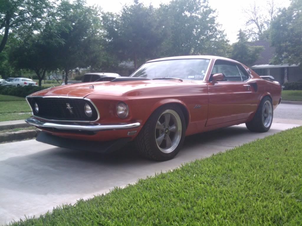

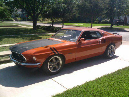

Photobucket account got all screwed up so most of the pics were moved into new albums.. So Im just going to post up random pictures. Im actually getting the car back from the shop monday from getting the motor freshened up!!
Ill try to go oldest to newest on pics..
