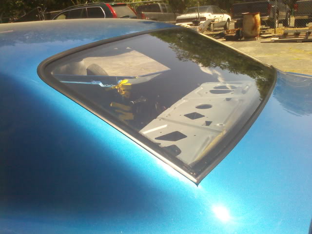

I just saw this post, It is not a lexan window, but is shows how windows can be fit flush. Also how it is trimmed with weatherstripping. Now I can appreciate the difference between trim to fit and OEM fit. (pics are not mine, Re posted from a different thread)
