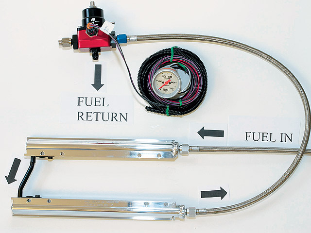

for my lt1 iam using this set up but iam running bradied line from my tank to the fuel rails it may cost a lil more but in the long run it will save u and also it looks very clean. if u dont go with a fairwall mounted fpr they make a kit u can put fittings on the old lt1 style regulator that will allow u to run AN fittings i will try a look for that site.
