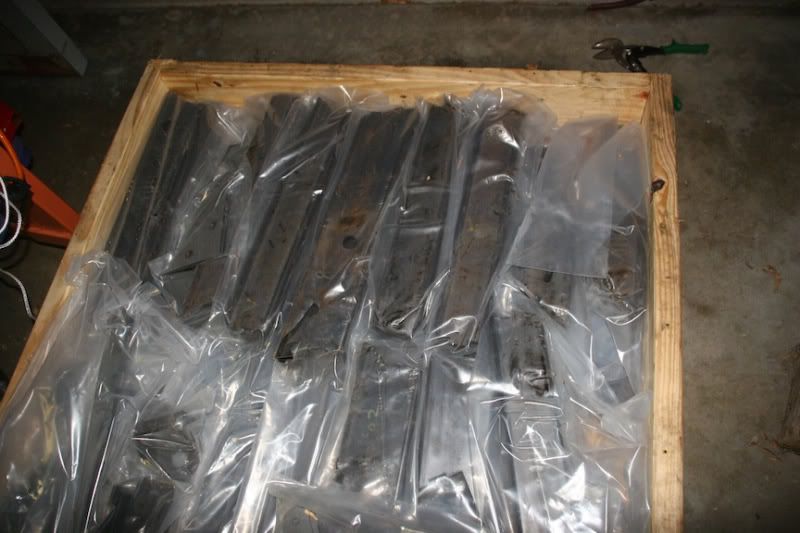

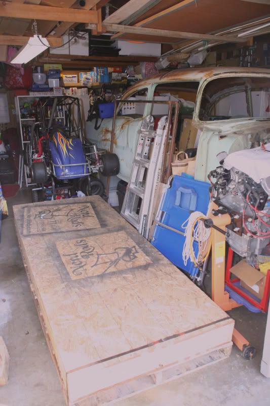

I decided to try out this kit. I've always got several projects going at at time and wanted to build something to test out some suspension and engine mods before I get to the final build. For those of you that might be interested in what this kit looks like, my flatpack arrived yesterday with the C4 kit.
The entire chassis fits onto a double pallet, 4x8x2. Smaller package than I thought (which is good). I had it dropped off at my house. At 400lbs+ I shoehorned it into the garage while I make space for the build. I put the crate on a pair of furniture dollies which made it easy to get into the garage from the truck.

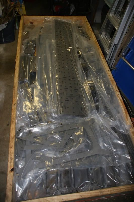

I ordered the welding tabletop along with the C4 kit, so this is how it was packed:
The tops are laser cut instead of water injection. I checked them for trueness and they are flat with no warpage. I need to weld the table tops together (top and bottom with some spacers that Russ included). This is not a job for a beginning welder. The tops are 11 gauge and can warp if too much heat is applied.

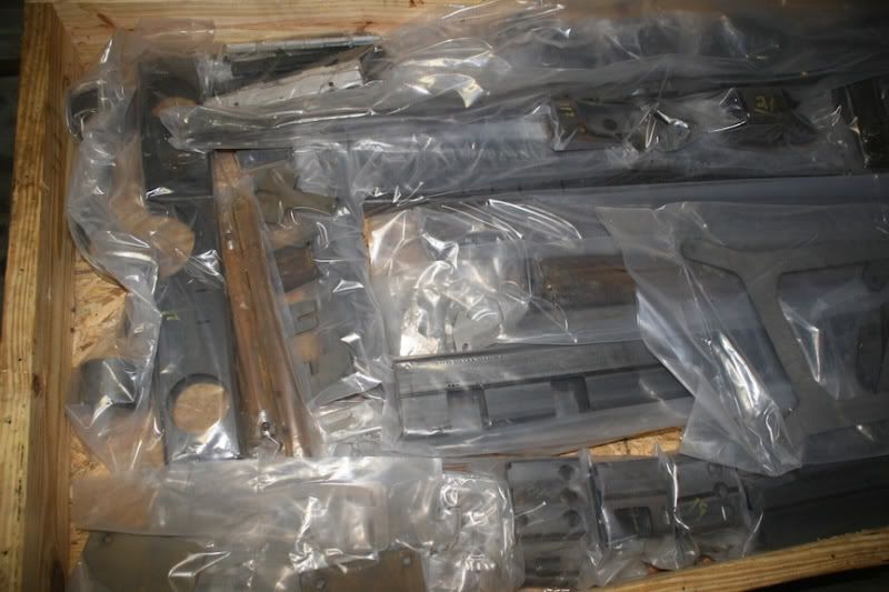

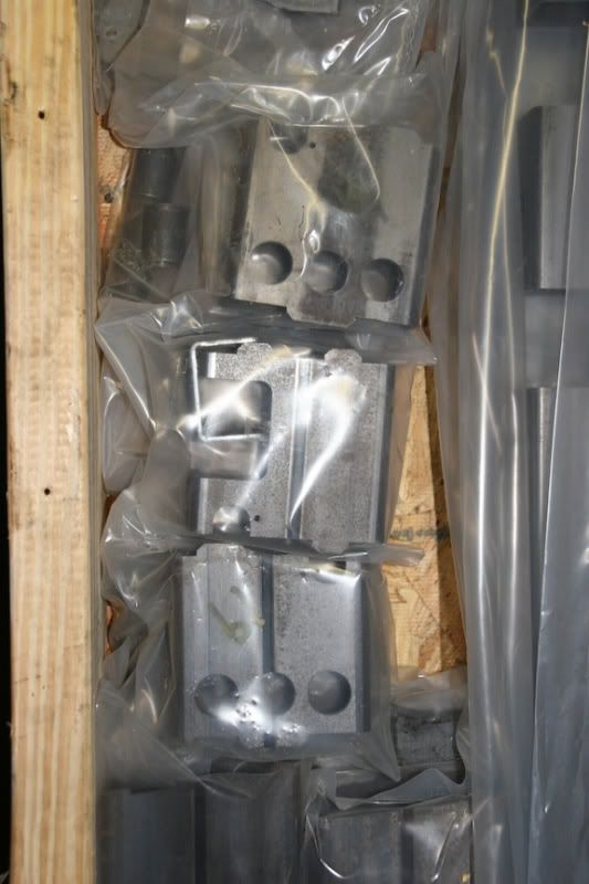

After I removed the table tops, this is the basic kit:
The laser cuts are clean and this looks to take average mechanical and TIG skills to assemble. It comes with some alignment jigs and all the subassembly parts are bagged together. The box tubing and other parts use 11 gauge, so this should be a solid chassis when I'm done.
It will be few weeks before I can start to weld the kit. I put in an entire kitchen from Ikea, so this has to be easier.
