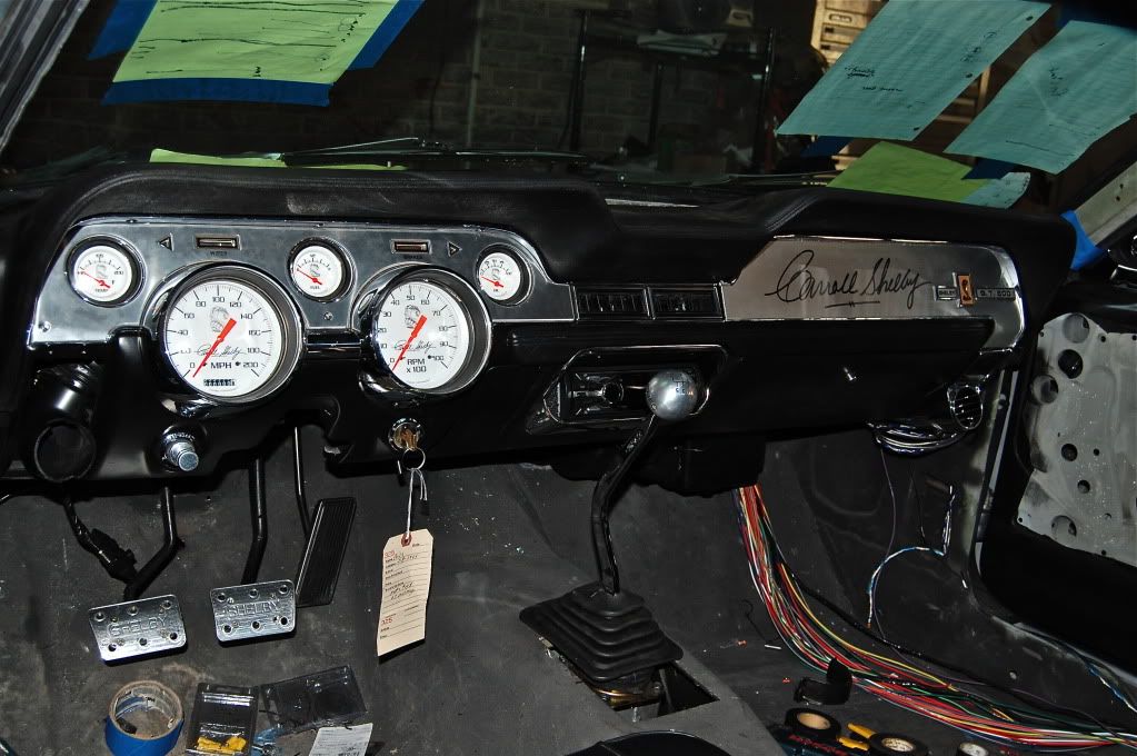

And here is my most recent update. I spent about 50 hours reworking and rerouting all of the chassis wiring and some of the computer wiring, deleting excess vacuum lines, making new engine grounds, reworking the brake lines, fixing the trans tunnel, wrapping the chassis wiring, removing excess wiring, tracking down wiring that was installed incorrectly and causing issues or going to eventually cause issues, etc and so on.

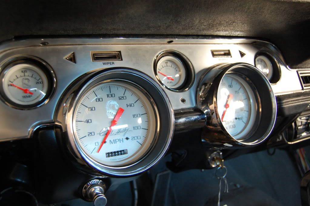

Finally finished the chassis harness wiring, or at least all of it that runs under the dash, wrapped the wiring, removed the steering column, repainted the dash around the gauge cluster, installed the gauge cluster, installed all AC ducts, relocated fan temp sensor, relocated crank sensor wires and wrapped them, wired AC compressor, installed a new ground for the fan, ran wires for trinary pressure switch, welded metal in to fix the shifter cut out, finally organized all wiring running to front of the car, wrapped all wiring running to front of car, and installed weather pak connectors on lights and wiring.

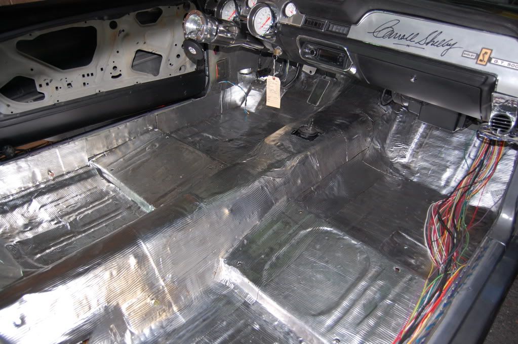

No Logo fat mat installed. It did not want to stick, so i glued it down with Weldwood contact cement.
I also spent 4 hours stripping the Krylon paint off of and polishing the steering column. I think it looks much better polished.
