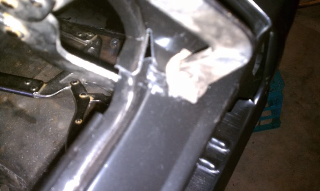

I got the trunk pan mostly grinded enough that I could start putting the back half together.
I welded the new trunk extension on.
Then started to fit the quarters there were some fitment issues but a little cutting and welding got it fixed.
I cut some of the tabs and had to adjust the weather strip channel but it fit perfect after that.
Had to use tie downs to pull all the body gaps together.
Then I welded all the body seams in the tailpan and 1/4's here are some pics of the tailpan.

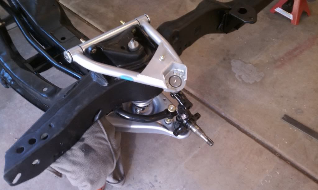

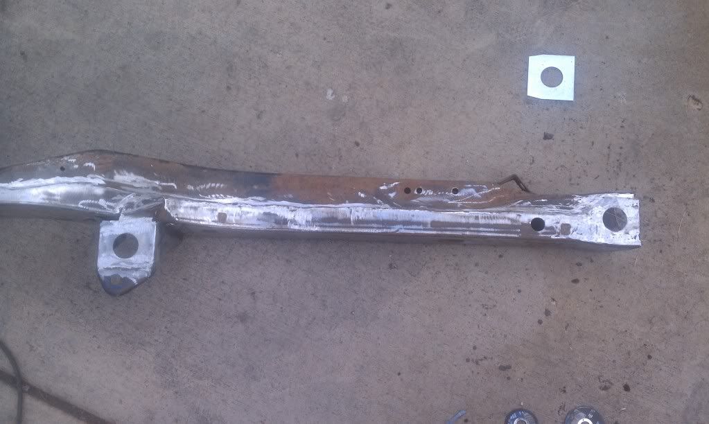

So after many months of body work I took a break and started on the frame and suspension. Also worked a few days on my buddies 67 GTO.
I replaced the body mounts on the frame mine were so rusted and wallowed out. I also welded the frame solid and ground down all the factory welds and splatter.
Then I painted it with Eastwood 2k with ceramic this tuff is so thick dont shoot it through a gun you care about it takes forever to clean and still cant get it all.
So I sold my motorcycle and went shopping on Lateral-g
I picked up my front coilovers from Bill Fadden his buddy posted them for him.
I bought CPP uppers and stock lowers with CPP ball joints and Energy Suspension Bushings. Ran all grade 8 bolts with advise from mild2wild.

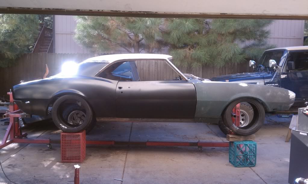

I picked up my tires a couple weeks ago from Gaetano Cosentina AKA trackjunky.Thank you very much for your help.Put the front fender on to see how they fit. Just motivates you a little more to see it like this.
Back view they seam to fit great had about 1/4 inch to play with. I was a little nervous when I got them they looked so wide I thought no way but it was a perfect fit.
Happy to hear the tires are going to work out for you. Progress is going great!!
