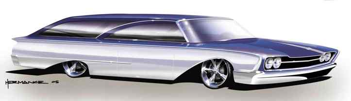

Default My other projects
Well let's see if the picture thing works.
The first car is my 60 Ford Wagon/Starliner. There is a concept drawing and an in progress shot from last summer. Its got 22s & 20s, Air Ride, Injected 514 Crate Motor, 6-speed, Baers, etc..
The second car is my 57 Ranchero. Also got a concept shot and in progress from last spring. Its also got 22s & 20s, Air Ride, Injected 460 Crate Motor, 6-speed, Baers, etc..
I'll have a web site up soon with these and a few more projects.
Thanks Mike
