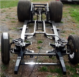

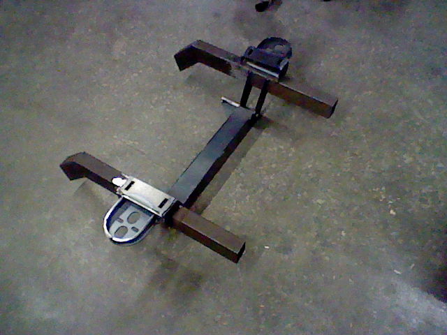

Please dont get me wrong, the fatman subframe with the mustang 2 is a great piece. I'm building a 62 falcon with a 4.6 mod motor and I built a mustang 2 subframe for it. Most people building a car on this forum is looking for the best handling setup available, and the mustang 2 lacks a little in that department. For a cruiser like I built with the buick and also my falcon,the mustang 2 is a good choice.Here is a pic of my subframe tacked up, I also put one in a 57 belair when I get the pic loaded I will post it.

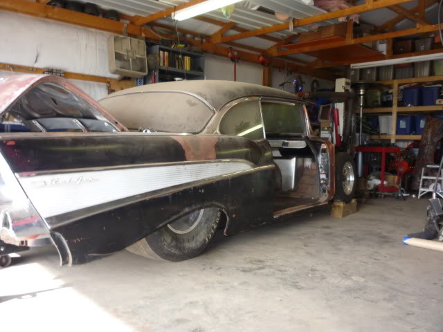

Here is the pic of the 57 chassis, super low customer wanted a 3" ride height. I welded a small scab plate on the stub joint plus the small plates on the inside. Should be very solid.
