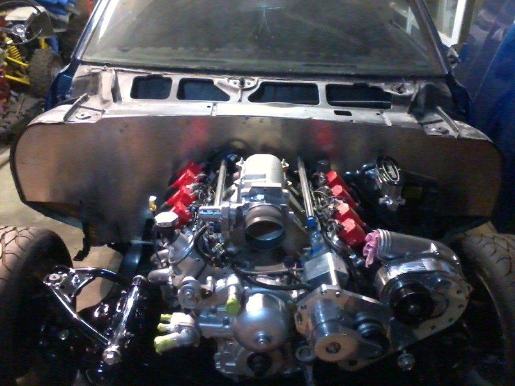

Originally Posted by DJW32 View Post
Everything looks great.
What pro-charger bracket did you use? Is this the universal LS kit offered by pro-charger?
Its the gto bracket. IM going to have issues with the head unit hitting the control arm. IM going to make some spacers/brackets.
I had originally used the gto bracket also. It just isn't a good bracket for the 1st gens. The Corvette bracket is much better. You also have to modify the inner fender too much. You also lose turning radius cause the wheel will hit the modified inner.
I think im going to put some spacers in between the bracket and the block to move it forward and have a pulley made or make a spacer for between the crank and the pulley. Or make a bracket to move the entire set up north a few inches to clear suspension and a arm

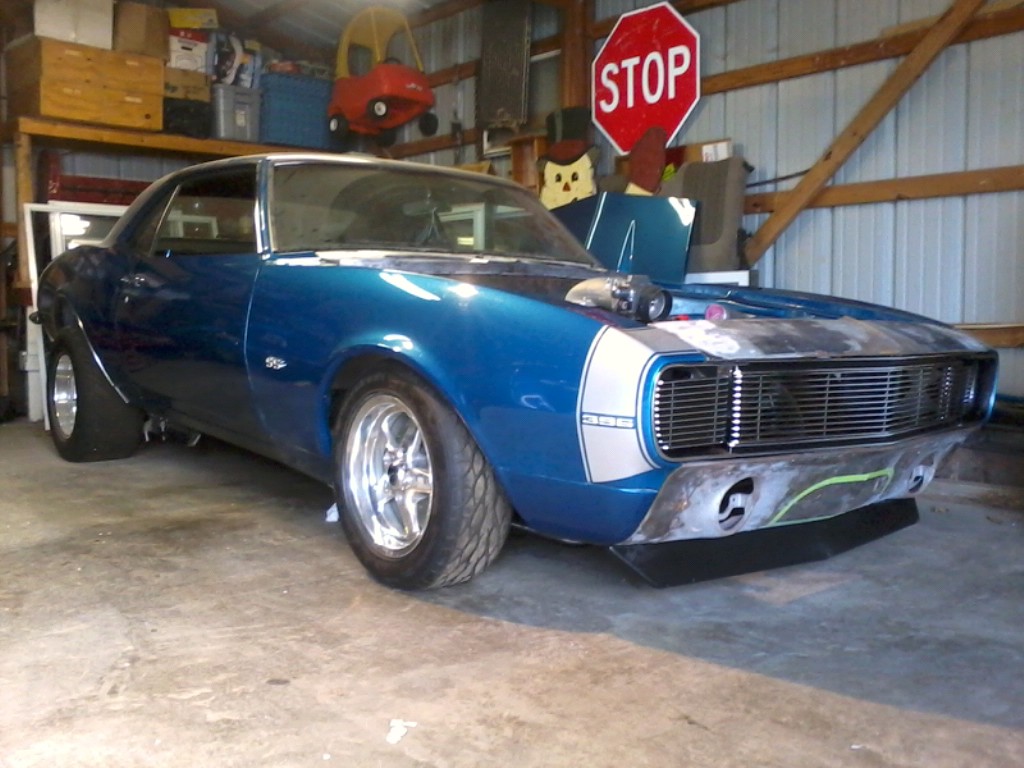

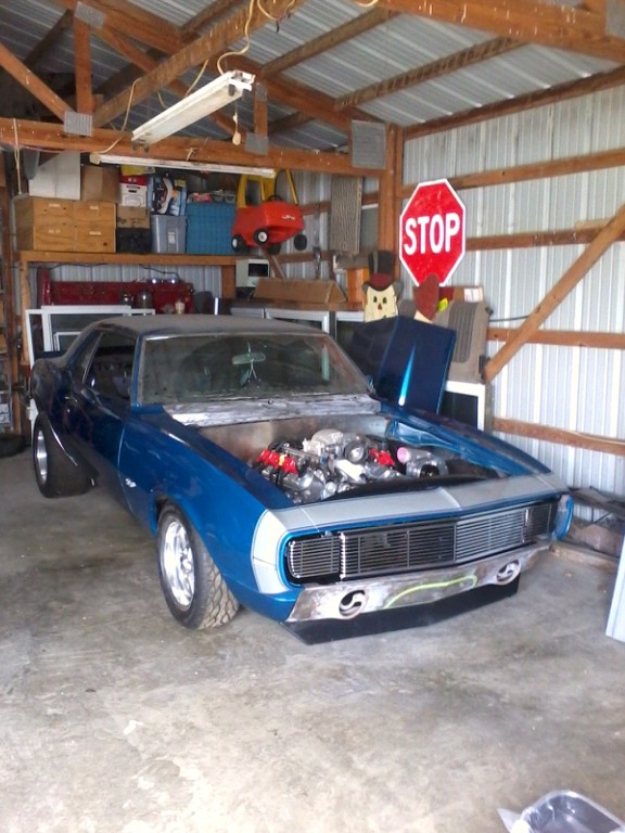

MOcking up everything...
Rs billet grille, custom valance, etc
