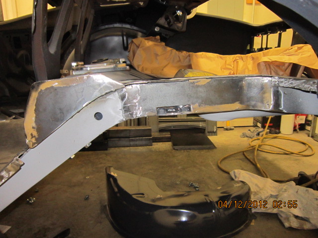

I'm still plugging away at the driver's mini tub. I am almost ready to install the new inner tub and complete that side. My timing for getting this done keeps getting interrupted, so it's been a bit of a slow go.
Also, I picked up a bunch of steel, pneumatic ram jacks and a geared hand winch for another project, as if I need more. I need to have this done ASAP, so it will interrupt getting started on my passenger mini tub install. However, it will help speed up the install and allow me to work more comfortably on all areas of the car.
Looks like you are building a rotisserie .... I can see in the picture where you notched out for the nuts, how you gonna close that off?

Yup, a rotisserie. I'll have it done, HOPEFULLY, by next weekend.
My week has gone nothing like I was expecting. I was taking off tomorrow to go to Super Chevy, but someone passed the buck on me and I have to take care of something in the morning and then can make the show
Only thing I can do is just weld a small piece of flat stock over the notch. My frame rail is stout now though
The plan this weekend is get the drivers side tub done and start drilling holes on the rotisserie. As soon as my round tube comes in I will begin to make the housing for the worm gear assembly. I have to have 2 sections of the round tube machined to fit the outer races of the tapered bearings. Once that is done, then I can do finally assembly of the roto
