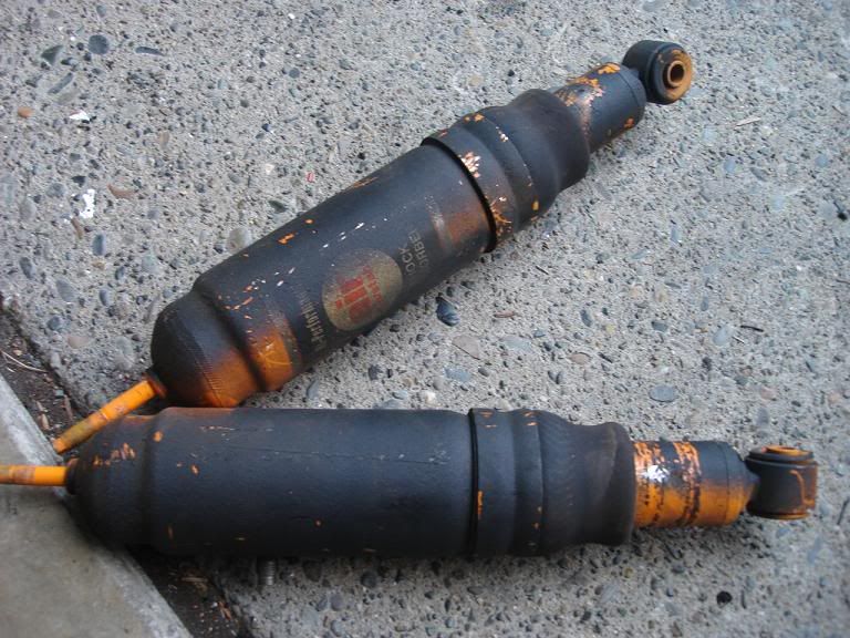

First thing was to pull out the original leaf springs, slapper bars, and the original shocks. Yes those are 30 year old air shocks lol I think the weighed 20 lbs each!

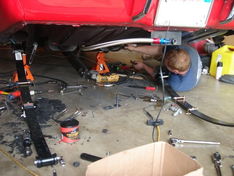

My brother hard at work. No lift for us- doing it the hard way. Had to modify the subframe connectors as they had been welded in right over the front leaf perches. New new plasma paid for itself instantly. These are the new Calvert split mono leafs going in. Also disassembled the entire diff and resealed it. Long, dirty, tough day. Beer was the reward.
Made our own lower shock plates to mount the rears in a more optimum place. Adjustment will be simple to reach now.
