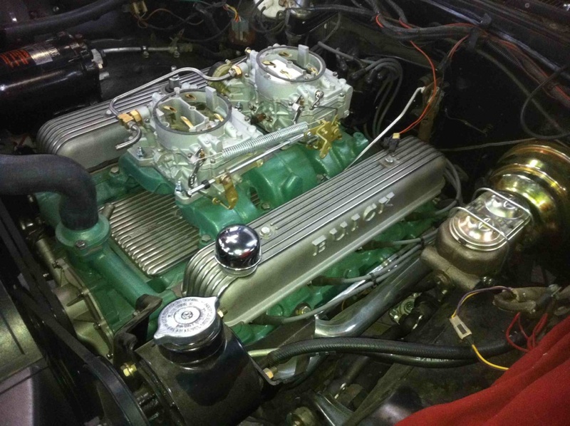

original nailhead

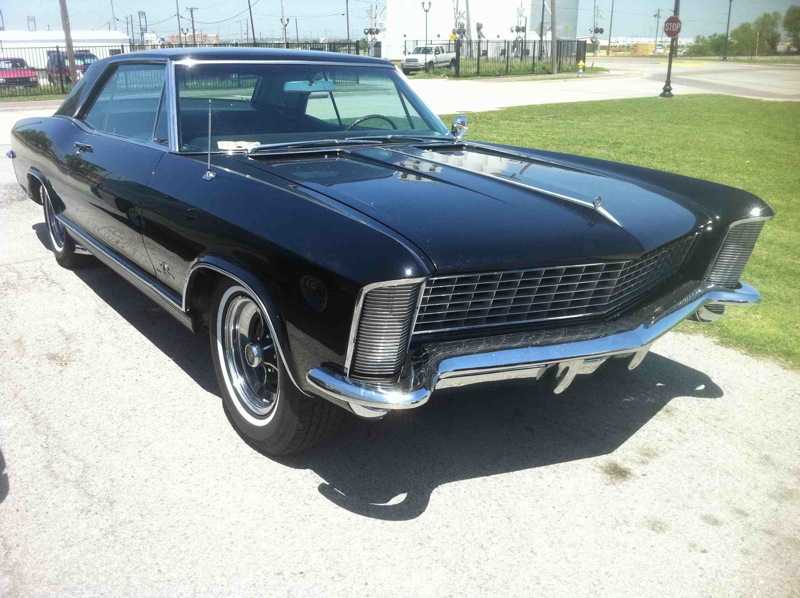

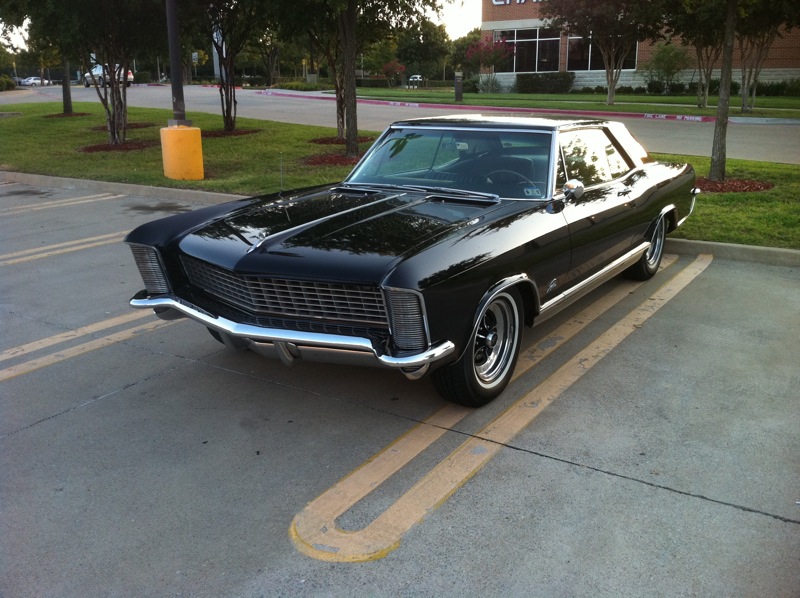

I anxious to watch your build. '65 Riv's Rule!
I'm guessing your will be black??
Here is what it will look like:
Project, "EnGULFed"
1964 Gulf Liveried, Corvette, "Grand Sport"
Ty O'Neal
"She Devil" aka. Betty
1969/70 Camaro SS
427 LS3, 600
Keisler Road and Track T-56
Full size 3 link and custom roll cage
315mm tires on rear, should fit the same on front. Worked to design a more effective shape.
"Chester's '65"
1965 Buick Riviera
Aiming for true PT Status with
the best available from the 70's and 80's

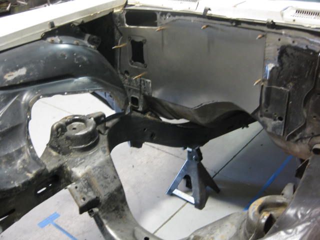

A few progress shots........
initial mock up of LS3..
In order to get our engine/4L70 trans where we needed it, a new tunnel was required...
the original console will bolt in like stock..
RS fast track installed, when the body is removed, all finishing welding will be completed
Steve Keefer

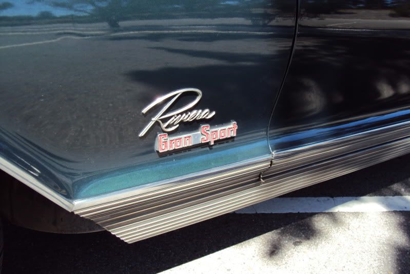

Torn here...really love the '65 Riviera's just like they are,glad you're not ruining that lovely Bill Mitchell designed exterior or interior...thay are both pure perfection.
Riviera Owners Association had their national meet 2 weeks ago here in Monterey,and while I agree the 65's lend themselves perfectly to be customized (and they had a custom class as well) but I prefer them completely stock...:yes
Trio of Black 1963's:
1965 GS's:
These cars are rarer then hen's teeth...
