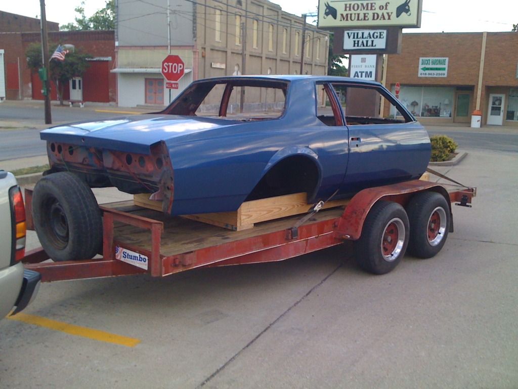

Once the body was removed from the frame, I needed a dolly to move and transport it. This was pretty simple. It was constructed of 2X8's and a good set of casters. The 2X8's stood upright fit perfectly into the channels on each side of the body were the frame rails set.
Once I rolled in onto the trailer as you can see in the photo below I have a 4X4 bolted on the front (and rear) of the dolly.
Here is how it worked.
1. Roll the dolly onto the trailer.
2. Put a jack under the 4X4 and jack up the dolly.
3. Unbolt the casters.
4. Set the dolly down onto the trailer.
5. Screw the dolly directly to the trailer wooden floor.
6. When you get to the stripper, reverse the process and roll it into the shop.
[IMG]http://i1250.photobucket.com/albums/hh531/fuman2/52.jpg[/IMG
More on the stripper next episode. His name is Fred's Fabrication out of Cuba. MO. There is not enough room on this forum to give him the credit he is due. He is the best!!! Look him up..

love the wheels. i was thinking yesterday about a dolly like that. thanks for doing all the work. now i am going to copy it.
