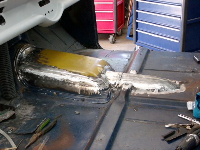

finished high hump....clam shelled behind it.....hump still removes...sneak preview of what's to come......jim

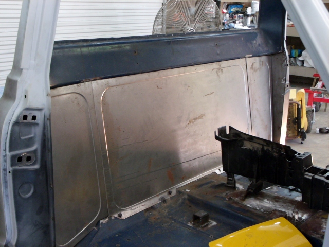

console only...cerullo seats....cab stays stock....well... pinch welds and cab corners shaved......jim

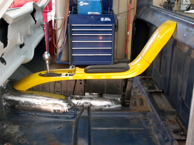

About got SSR console fitted..seats fitted..Also rear cab panels from porterbuilt...slick!..New shifter plate with auto shifter but 6 speed boot....liked this look better than "mechanical" look of auto plate...that new plate was 1 of only 2 in GM system....ssr parts not easy to find.....working on e-brake mount now.....jim

Love the design, but is the shifter too close to the dash? How does it work out ergo-wise w the seat fittment?
Actually fits very well....pics may be a little misleading...shifter in comfortable position as is console...looks tall in pic but real nice when seated...Can't tell in pic but I actually spent a couple of hours moving shifter rearward and hence the upper piece of console that lays on the rear wall had to be refitted on a different angle....it angles up more than stock and therefore had to reshape where it mates to console...PITA but results were worth it...jim

Looks good to me.

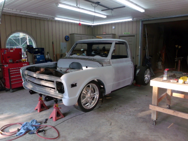

Doors mocked and front sheetmetal...working on bear claws and Ring Brothers door handles this week..........jim
