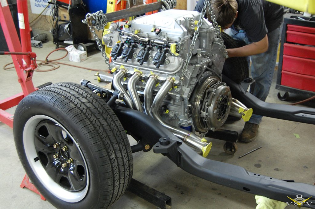

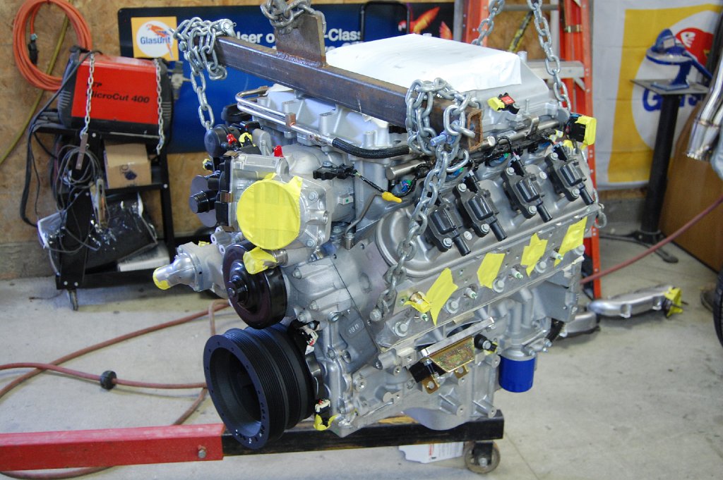

Here is the Bad Boy LSA that is going into Lou's Change. It is a CTS-V spec GM crate motor. After mock up it will be sent to Lingenfelter Performance Engineering for them to work their magic on it. Heads, cam, porting, pulleys, tune, etc. are all part of the Lingenfelter plan. The goal is gobs of torque and over 700 reliable and trouble free horse power.

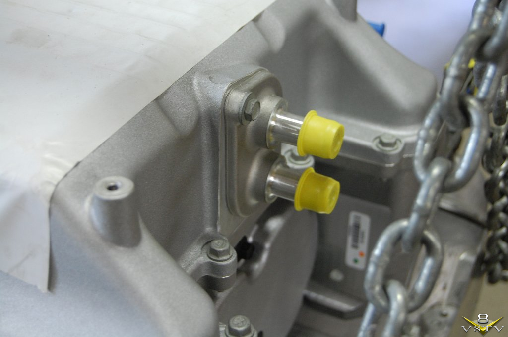

You will notice it has the CTS-V top hat on the supercharger.
We're hoping to go with the new ZL1 top hat because it has the intercooler lines coming out the front, an improved heat exchanger brick inside and a shape that improves air flow overall (according to the GM literature).
In addition, the intent of the Lou's Change concept is to include tributes to the ZL1 vs. than the CTS-V. Hopefully the ZL1 top hat is going to fit under the stock SS hood.
Here are GM pictures of the parts used in the CTS-V spec LSA motor and the ZL1 spec LSA motor. You can see the differences in the supercharger top hats.
The CTS-V has rear exiting intercooler lines and a profile that slopes down in front.
The ZL1 has front exiting intercooler lines and the profile does not slope towards the front.

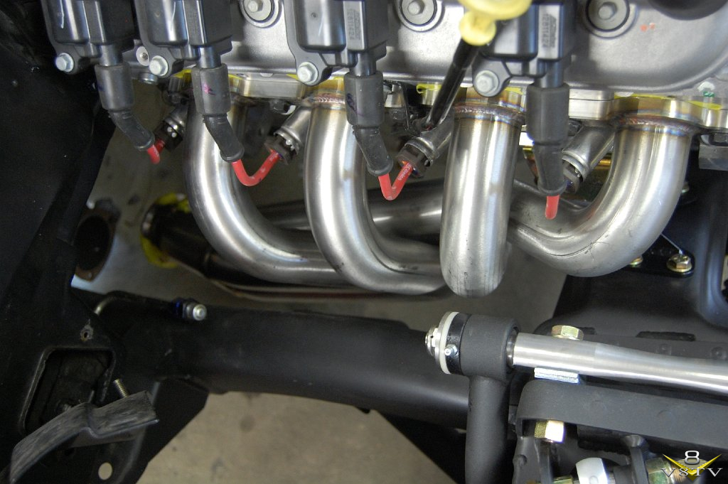

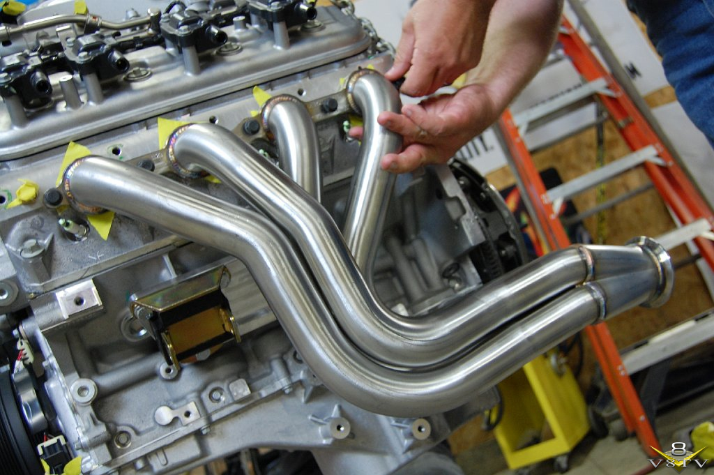

The Detroit Speed headers were ordered to make sure everything would go together as a totally engineered and proven system with minimal surprises. Yes, they are expensive but look at the craftsmanship. They are works of art in my humble opinion.
The CTS-V tophat has the intercooler lines exiting towards the rear.

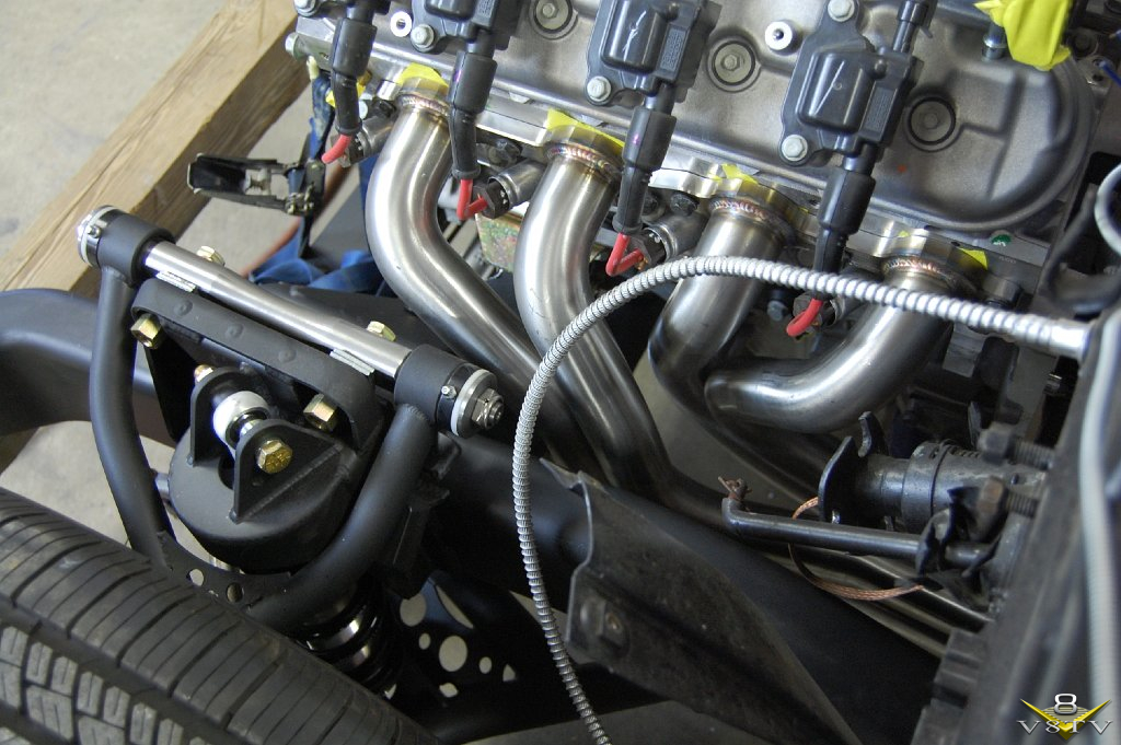

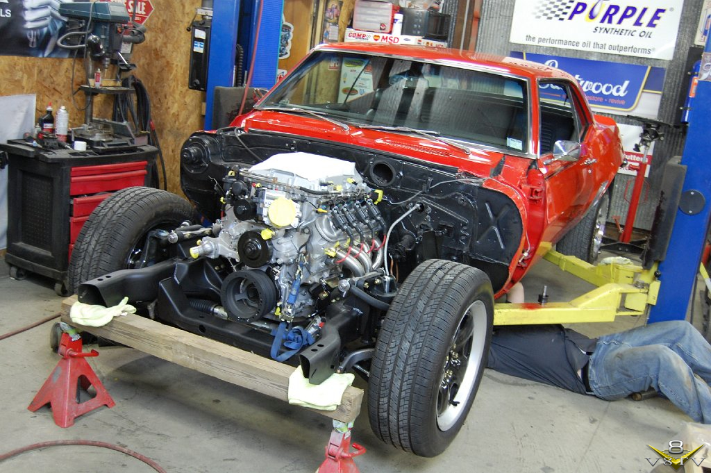

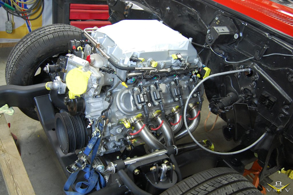

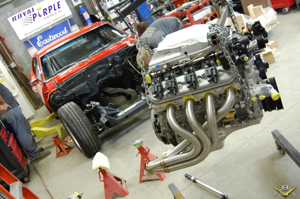

Mock up has officially begun. Trial fitting of the Detroit Speed subframe looked perfect as you would expect.
We had to find some rollers that would clear the 14" Wilwood rotors we've ordered so we picked up a set of 2012 Camaro takeoff wheels and tires.
Hopefully, those tires will fit in the wheel wells...if not we'll have to find some lower profile tires for mock up.
We used Detroit Speed's subframe, steering rack, motor mounts and headers so everything fit together very nicely.

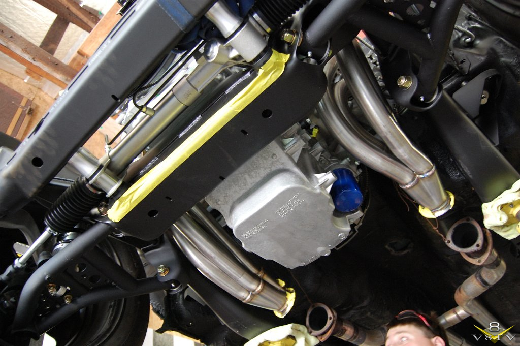

V8TV will custom fabricate a custom cross member for the T56 Magnum transmission and notch the subframe to clear the A/C compressor mounted in the low passenger side location as it is in the factory CTS-V and ZL-1 configurations. That will allow the use of the
OEM front accessory kit we ordered with the crate motor.
We could move the A/C compressor mount up high but we're in pursuit of the cleanest engine bay we can achieve as inspired by Charley's Jackass Camaro.
Kevin and Trevor have been kicking some ideas around in that regard.
Everything fits so nicely so far..

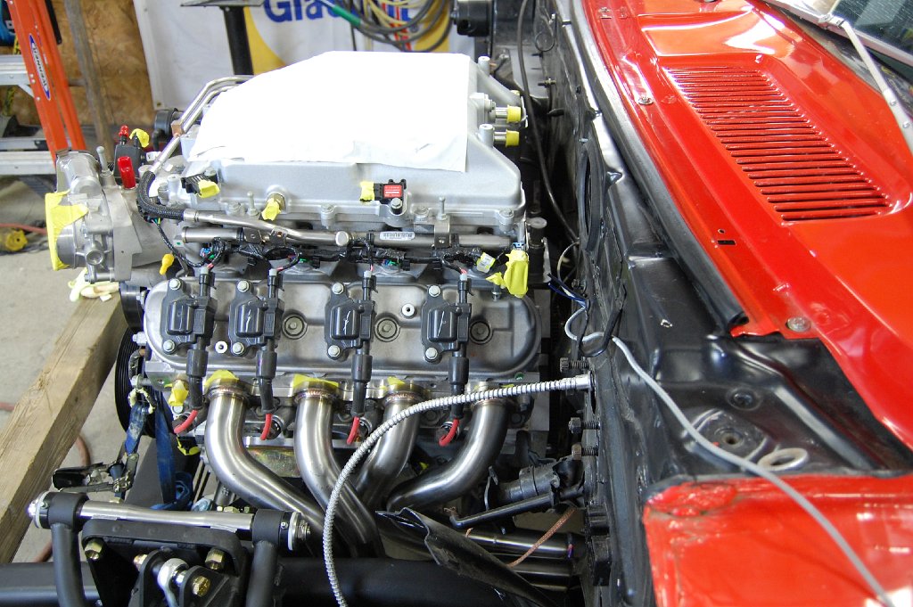

Looks like the rear exit supercharger intercooler lines would not have had a conflict with the firewall afterall.
As I said before, we hope to use the ZL1 top hat with front exit coolant lines anyway.
We're shooting for well over 700HP at the crank with all the Lingenfelter mods. Those are the kind of numbers we feel the CTS-V crowd and all the tuners have proven is safe without having to also beef up the bottom end of the LSA crate motor.

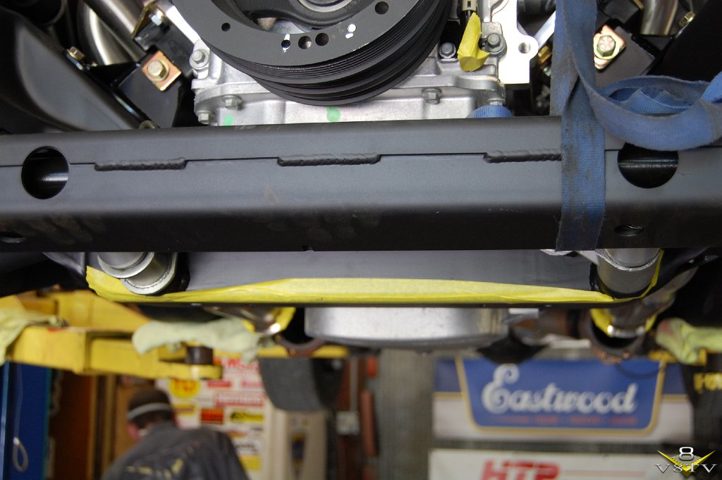

As you can see, the LSA oil pan hangs down below the subframe a little bit. It's not hanging down any more than my old motor did but we may need to get a different oil pan just to be safe.

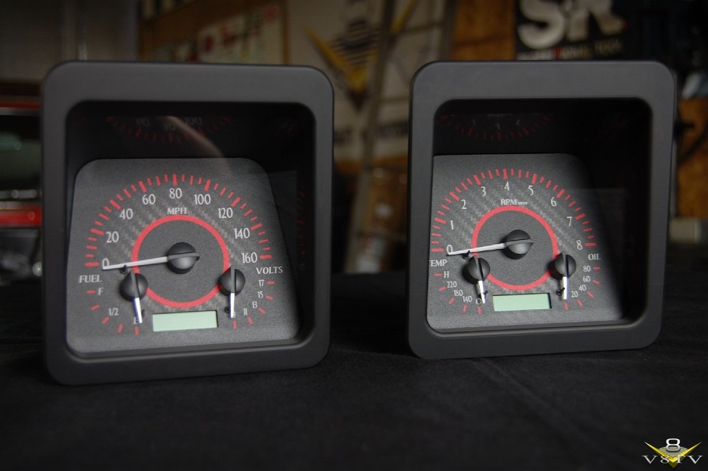

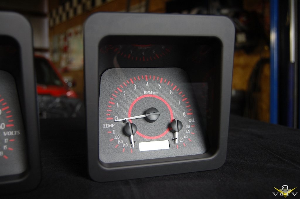

Here are some pics of the new Dakota Digital gauges we are going to use in Lou's Change.
I want the interior to look mostly stock but to have modern gauges. When Dakota Digital came out with these 69 Camaro specific pieces they were the obvious choice for me.
They can be programmed to display all kinds of things including temperatures, pressures and even performance results.
For instance, they can display 0-60 times, 1/4 mile elapsed times, etc.
Very cool eh?
