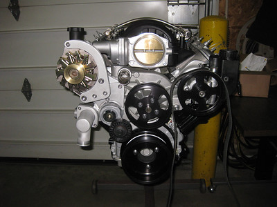

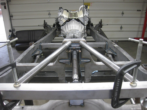

Thanks guys!! Here are some pics from the last 32 redeux.....
built my own accessory drive from half a VintageAir Frontrunner
[IMG][/IMG]

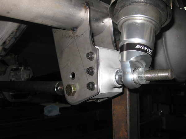

Rear coilover mounts came out cool. Single shear, I know, but almost all hot rods are set up this way. I can rotate the billet piece to adjust ride hieght up and down and change the angle on the coilovers.
[IMG][/IMG]

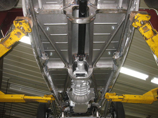

3 link in this hoopty. That giant crossmember is right behind the seat.....
[IMG][/IMG]
The floors were styled after a 34 Ford.....sort of. Yep steel floors, plastic car
[IMG][/IMG]

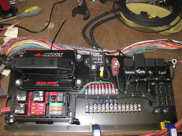

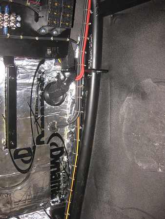

Wiring panel getting started. All tied with wax string, I learned from a guy that worked at the power company. If I get on a roll it is actually faster than zip ties.
[IMG][/IMG]
[IMG][/IMG]

Bad ass stuff. What's the powerplant consist of?

Simplicity....2011 5.3 takeout that I bought from SLP on ebay as a long block. Eliminate the afm, Mast cam (along with their harness and ecm), LS2 intake and LS3 throttle body and a stock LS3 oil pan.
