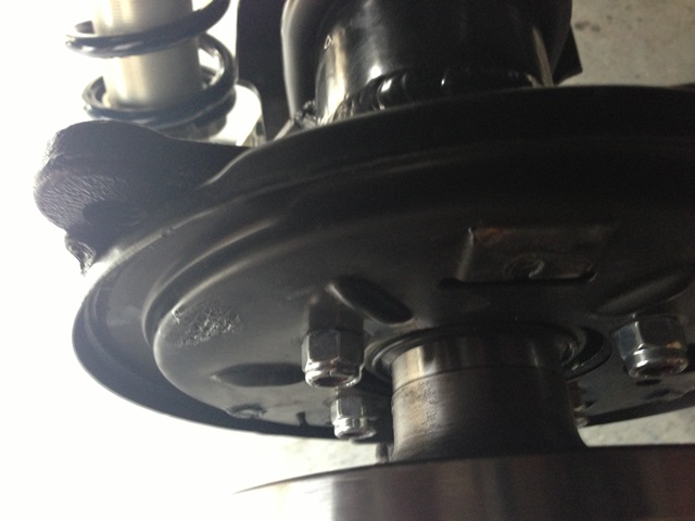

Posted this on PT and here, hoping someone can help me:
Hoping you guys can help me out of this mess I think I created. I narrowed a 9" Ford I had and used Moser 7900 housing ends. These maintain the Ford bearing size while using the GM pattern for the brakes. My plan was to use LS1 Camaro/Firebird brakes. While talking with QT performance about ordering axles, he said:
"I hate to inform you but the ends you need for those brakes are Part # 7900FM. The difference between these ends and the ones you have is the 7900FM are called "flush mount" as they let the axle bearing sit flush in the housing end. The bearing bore is deeper. The ends you have will leave the bearing sticking out 1/8", which is common for the 9" style bolt in axles. The factory 93-02 Camaro backing plate will need to sit flush against the housing end to work properly. One might be able to carefully machine the bearing bore deeper to allow the bearing to fully seat."
I've put way more work into this rearend than I want to admit at this point, all the points for my 4 link are welded on, housing is completed. Any suggestions on how I can salvage this? Can I remove the 1/8" from the brake backing plate? Has anyone else run into this issue? Any advice appreciated

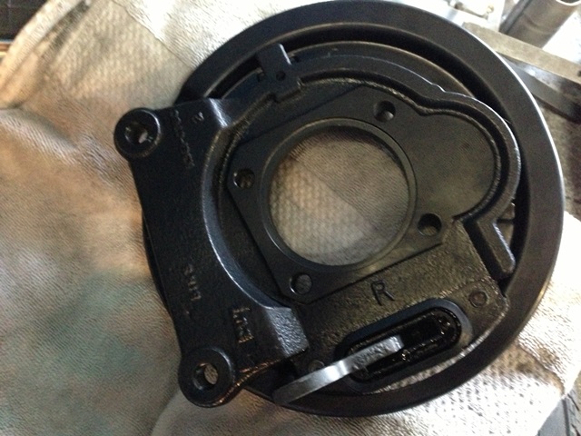

It is acceptable to remove the material from the Caliper mounting bracket.
0.145 deep and 3.155 dia. should get you what you need and allow for bearing preload. This is what we have done in the past for our customer's that ordered complete assemblies with the Big Bearing/3.150 style housing ends.

I'm running these brakes on a 12 bolt with 9" flush mount ends. I wouldn't machine it out of the backing plate. Remember, this part was engineered to only attach the brakes. We're asking it do do even more in this situation since the C-clip rear it didn't do any axle retention. Machining out for the bearing will only leave the "retainer" weaker.
Another option to machining the caliper bracket would be cutting a spacer out of 1/8" plate. Quick, simple, cheap.

So basically what your saying is to use a 1/8" piece with a bore to match the housing ends (3.150, I believe?) before I slide the backing plate on? Won't that affect the spacing needed? The stock axles I have right now (for mockup only) are the 2-3/8" offset version. I believe I can get a different offset when I order my axles.

What I did won't solve your backing plate/bearing issue - you would have the same issue w/S10 backing plate - I was just pointing it out as a solution if you have LS1 caliper clearance issues. Also, I'll see if I took some pics but as I recall my bearing protruded just a little even with the flush mount ends, but nowhere 1/8". -Bob

Thanks, I got that; If you can post a pic of that so I can compare what mine looks like, that would be greatly appreciated.

So what your saying is to remove the 1/8" of material from the center of the backing plate? Would this change the alignment of the rotors to the abutement bracket/caliper?
