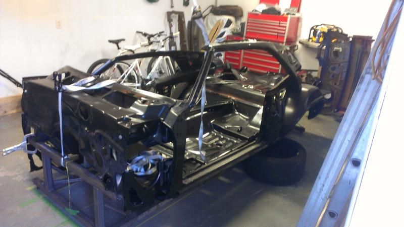

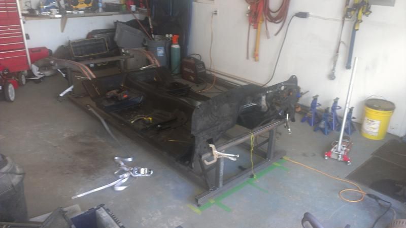

2.0 jig done
I little bit of precision (fisher measurements 1/8 tolerance)
I got less than 1/16
Start to assemble the floor but no more gas for the welder so thats it for this week

Nice project, and nice job on the jig.

Thx, as you know, its not simple as it look

Nice work on getting the jig precise. Good luck with getting the car back together!

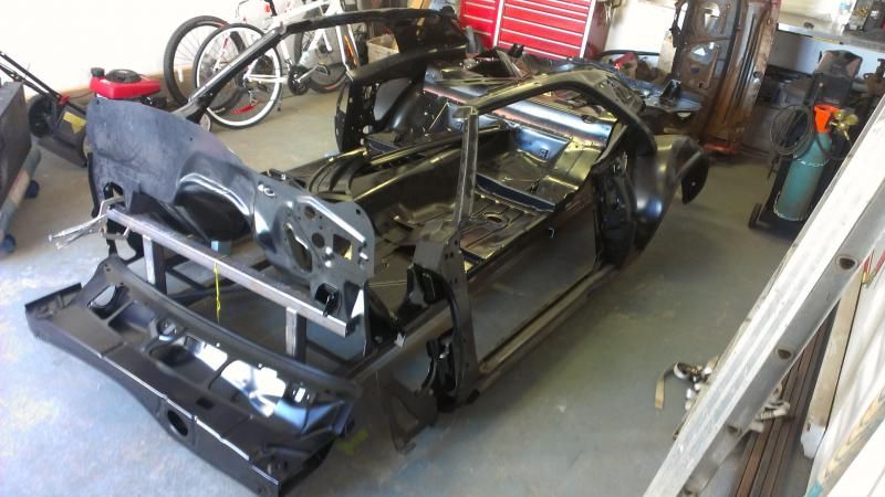

Floor is now assembled, not welded yet because I want more body panel to verify alignement. Bolted with metal screw because the cleco cant hold the stress of the differents arch of the trunk floor and frame rail(taiwan quality).
I will order structure panel next week, thank for support.

Nice work. Hey you may think of a bigger gas bottle. That bottle won't last for this size job.

Cool project and it looks like you're off to a great start! Keep the momentum going and you'll be driving it very soon
