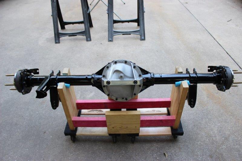

Just a little something to be able to free up some space while working on other things...

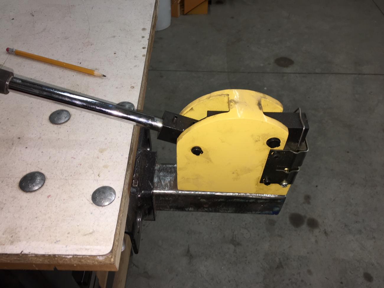

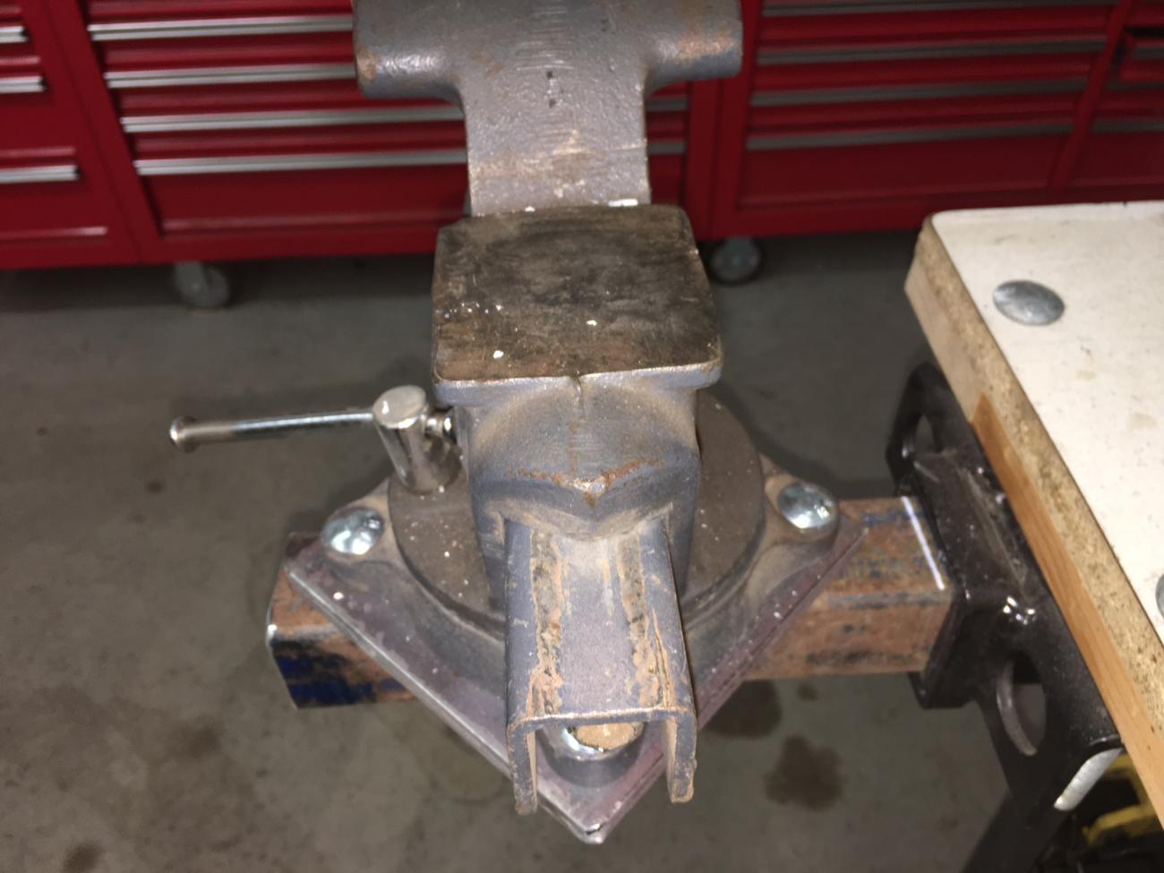

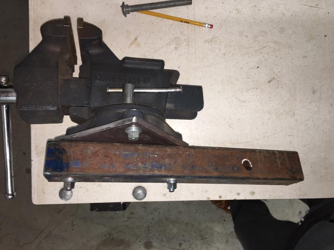

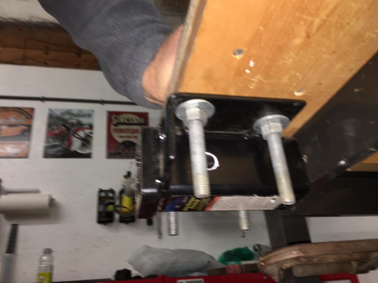

I was thinking of this old thread the other day when I finally mounted my vise, it took me a while to find it (the thread).
I'm a member of Garage Journal, I think since 2006, and learned this hack from there. I mounted my shrinker/stretchers a couple of years ago and got tired of going from my shop to my garage to get to the vise.
it's just a cheap receiver mounted under the bench and section of square tubing I had on hand. I did have to pay $10 for that 1/4 plate under the vice.
I store the "loadable" items under the bench with square tubing, angle iron, and other pieces I fabricate.
