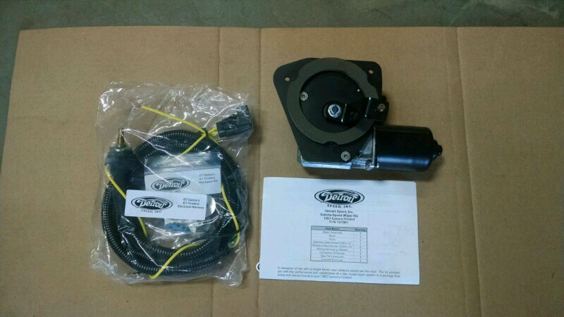

Just finished installing a DSE Selecta-speed wiper kit in our 67 c10. I started with a 67 camaro kit. They do have a universal kit but they were on back order and we found this one in stock from a dealer. It can't be a "bolt in" since the stock bracket must be removed, but wasn't very difficult. It took about 3 hours to do.

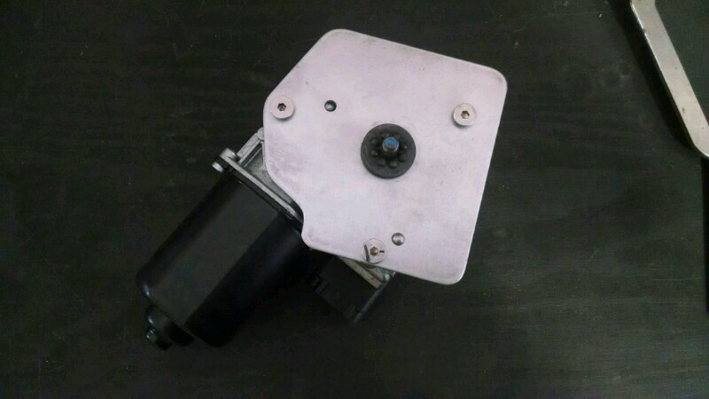

Using the 67 camaro bracket as a template, it was cut to fit. The edge on the left fit perfectly vertical with the motor mounted at an angle out of the way with no interference.

1/8" steel plate was used. This gives the right spacing for the shaft to protrude thru the cowl. The shaft hole is slightly smaller than the DSE plate to seal around the rubber grommet.
