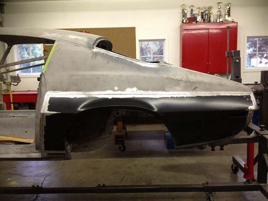

Here are some pis of the car after blasting. I replaced the passenger side rocker, built a small piece for the bottom of the quarter and replaced the drivers quarter skin. The trunk is in and window opening(verticals on sail panel) is also in but needs welded up. I wil post more pics this weekend.
Thanks, Cal.

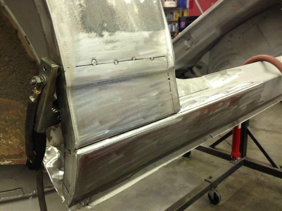

The rocker was fairly easy but these small patches in front of the wheel open were more work than expected. It's layered and has a heavier gauge inner structure that also ties in to the wheel well lip.
