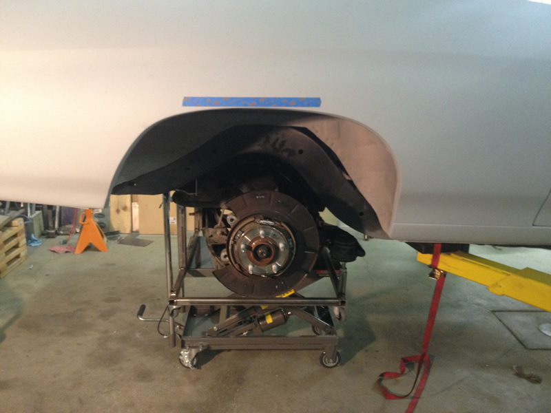

Hers a little sneak peak... on the first trial fit.. these were taken a few weeks ago...before I started cutting the car up...
note: the second pic is not the one going in the car.. but it looks exactly the same just a few different parts

How wide are the 5th gen Camaro IRS unit's.
Ill have to look at my notes when I get home... but I want to say it was only a few inches wider than the stock rearend out of the Chevelle..
